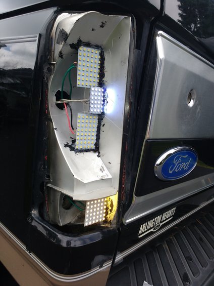

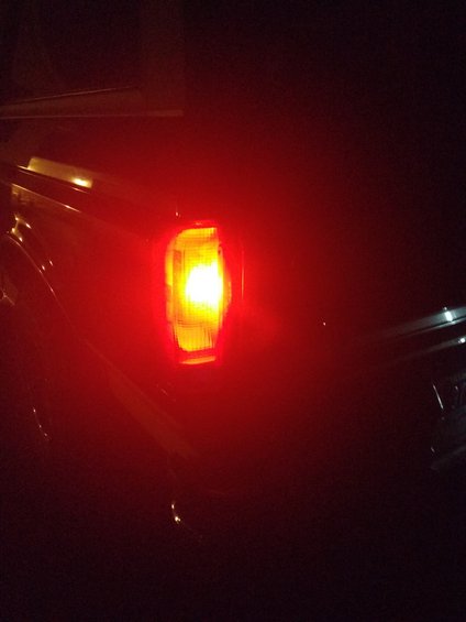

Next project was to modernize it a bit more by fabricating some LED taillights. I got some inspiration for this project.

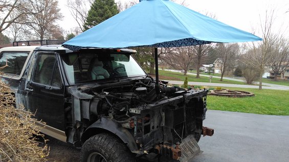

Then I moved on to a bit more actual car stuff. I wanted to have nicer looking tailpipes, as the current muffler had none and was situated directly under the cab; there was some exhaust noise to say the least. I used pre-mended Walker pipes, and worked my way around the rear axle.

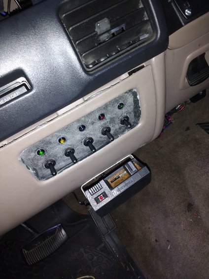

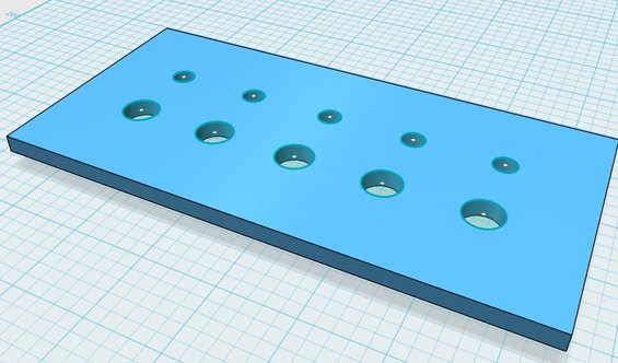

I was feeling very ambitious at this point, I had the time and money so I found a new project. I needed a switchboard for my lighting accessories, so I decided to make one. First I modeled my switchboard in a 3d-designer.
I got the switchboard 3d printed and went to work designing the switches and wiring. During this I installed led strips underneath the dash, rear seats, underneath the rockers, and designed a light to fit inside a hole that the previous owner(s) mysteriously left above the seatbelts. I also repaired my upper center console computer with a new capacitor and some led lights.
With some design inspiration, I bought 3-way switches and led pods of various colors for the switchboard. Each switch has 3 modes. (On, but only when natural. IE: Interior lights on when door opens, or any other power received that would normally power lights), (Off), and (ON, power received directly). They're wired to the interior lights, exterior rocker led strip, my lighted visor, the reverse lights (to get people off your butt, and connected to my rear view camera I installed), and my led pods on the front bumper.
There it is installed, but not cleaned up. The edges of the glue were made to look nicer.

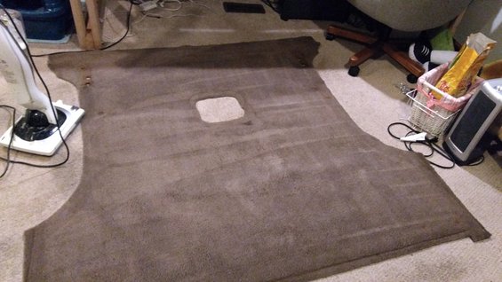

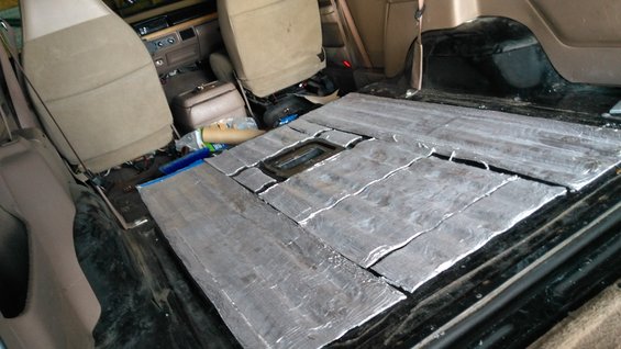

Oh yeah, and I completely overhauled the cargo area. The rear seat was rust-welded to the floor. I spent a week and a half drilling out the old bolts and installing new ones. I custom ordered new springs also. Then after the carpet was sufficiently cleaned I installed some sound proofing. This was a much larger project than it looks, but I know it will make the truck last longer.

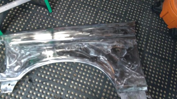

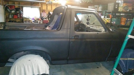

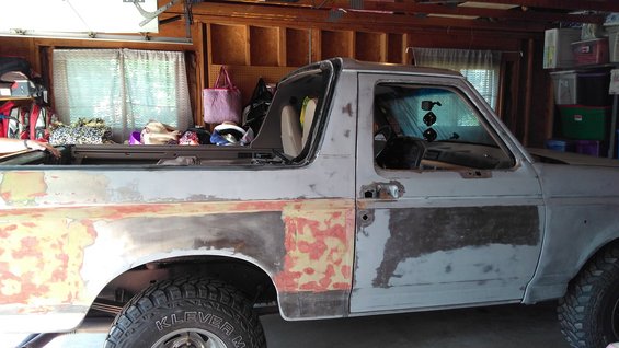

Next, instead of taking an actual break for the spring, my workaholic self got obsessed with body work. This took from December to September. I started off by stripping the front fenders and hood to bare metal.

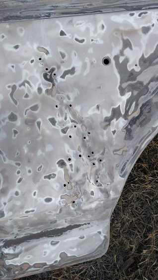

I came across a ton of rust and bondo, which is never a good mix. The previous owner had never heard of a spot weld dent puller.
Through gifted circumstances, I had the opportunity to visit a Ford dealership's body shop to learn how to apply body filler and paint correctly.

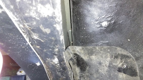

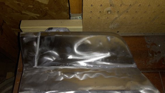

I've skipped some time here, but you get the gist. Through great Ford designs of 1996, there were rust spots on the fenders. A pocket between the inner and outer fender allowed mud to cake up and create rust. These parts had to be replaced.

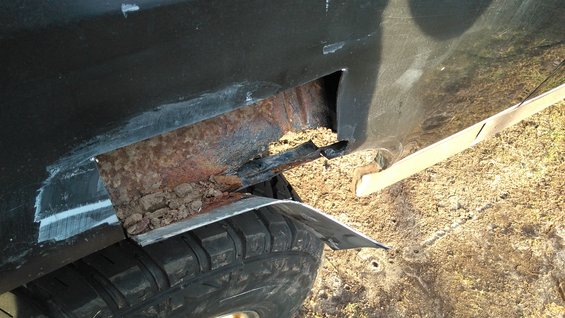

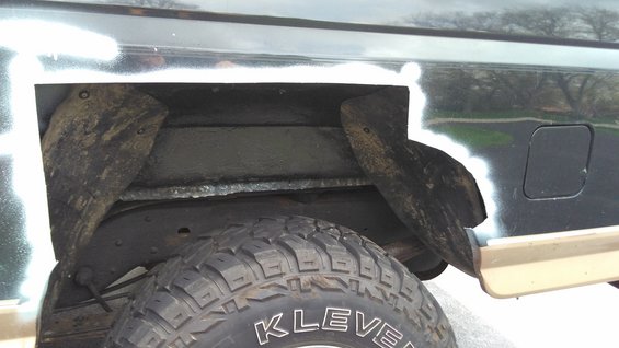

Continuing on with the body work, I found quite a few FIDs (Ford ingenious designs) throughout the truck. An example being the rear wheel arches. The rear wheel arch is composed of two pieces. The outer, obviously, and the much unneeded inner arch. The inner arch is made of steel, and would work great if weren't for the fact that dirt can easily get built up on the crease between the outer and inner. So then rust happened..

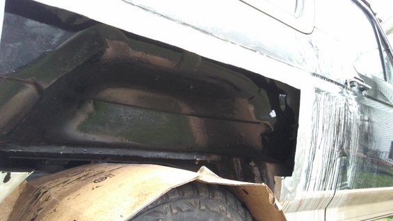

My solution to this was to replace that entire portion of the arch. For someone who had never done anything of the sorts, this was a learning experience. I taught myself how to replace panels like this through trial and error.
I decided to cutout the entire inner wheel arch, it seemed unnecessary. I gave it's purpose to some plastic, which isn't known to rust. Por15 was possibly a truck-saver. It allowed me to paint the entirety of the inner fender well with a hard rust proof paint.
Using the Eastwood panel rivet kit and 3M panel adhesive I applied my new panels. This was very stressful honestly haha, but my parents and neighbors were sure glad to have them filled.

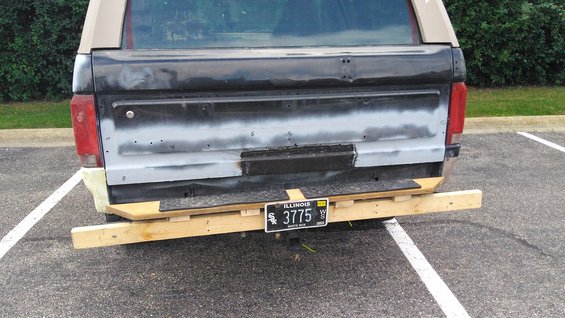

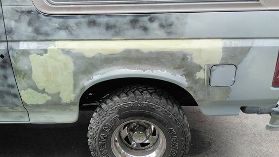

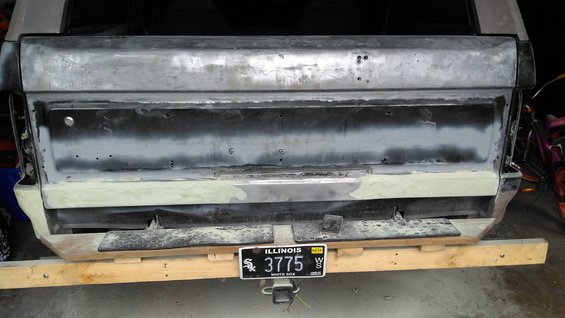

With both rear quarters replaced, and my tailgate panel repaired on only the..third.. attempt, it was time to begin the second half of body filler.
Haha just kidding, I found another rust spot.

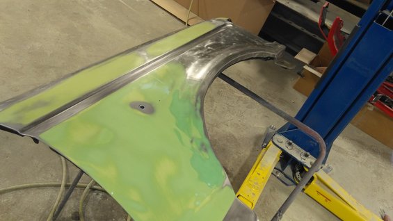

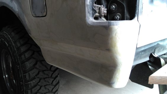

No but seriously, here's a compilation of the body filler progress.
I did the body filler myself, until the last moment where crunch time hit and I need help from family to finish the glaze and prime. I want to thank them a ton for helping get all that done in a weekend.

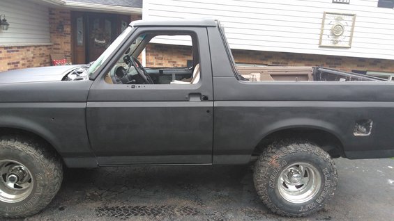

The body filler came out really great, it never really felt like that until the very last moment, but it worked out! Next it was time to prime. I went with Rustoleum Professional Rusty Metal Primer, and rolled it on using 2 different sizes of foam rollers and some foam brushes.

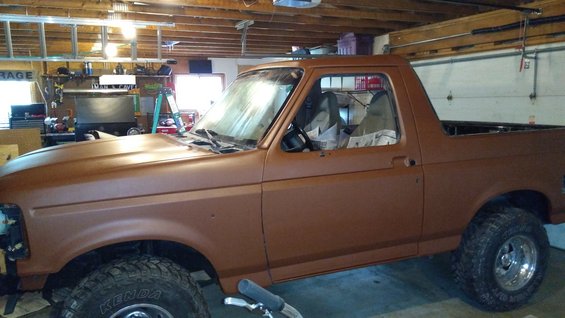

After five coats of primer, and the priming of various parts and pieces, it was time to paint. Again I went with Rustoleum Professional Flat Black Enamel. Same application technique, but for the last coat I thinned it quite a bit with mineral spirits. I did the painting alone, in order to take the most time and care.
The paint looks rough in these pictures, but it was sanded and another coat (thinned) was applied to even it out.

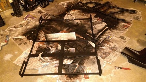

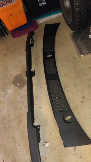

I actually sprayed the external pieces with the same paint, because it could be laid flat. I also painted the roof rack and tire carrier, both with rustoleum professional rattle-can bed liner.

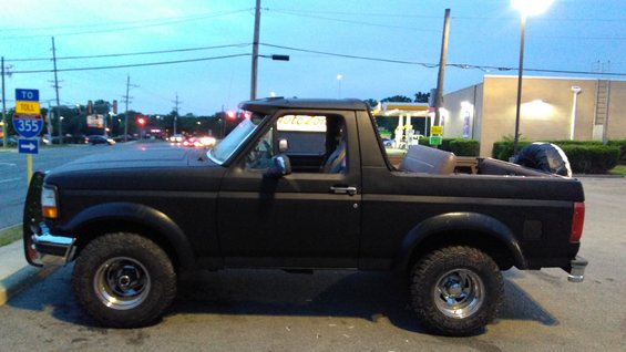

The paint came out amazing! I plan to paint the top with tan bedliner, and maybe the bottom part like oem, but we'll see.
Thanks so much for reading my build thread! I had a ton of fun, and learned more than I thought I could during this adventure. I'll leave you with my SuperMotors gallery link and some beauty shots.

Awesome job!! That truck should last you a long time. I bought my 89 when I was 17 for 2500 back in 98. I still have it and just cut rot out and welded new metal in for the 2nd time. Keep a close eye on the bottoms of the pillars, and front and rear body mounts. Eastwood has some great products, the internal frame coating works great for the boxed sections of the framework of the body. Did you cover the holes on the front of the forward body mount support? Ford has put holes in the inner fender to make sure that road salt and crud get right into there.

I don't exactly know what you mean by the holes in the front body mount support? Is there a FID (Ford Ingenious Design) there?

Right behind the bottom rear of the front inner fender on the front face of the body mount support. If you pull the inner fender off you will see it, it's approx. A 2x4" hole
