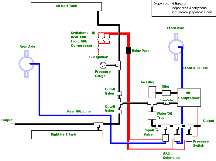

http://www.fullsizebronco.com/forum/showthread.php?t=40130&highlight=onboard+air
I'll try and get a pic of mine in a day or two. I add a few drops of air tool oil every now and then instead of using an oilier. The freon has a lubricant in it which is, of course gone when you do the conversion.
This should help.....
Wow - thanks for the responses, and the diagram! Really appreciate it. Pictures help!
Nice diagram Kenny.:thumbup
Yeah, ain't that purty? :toothless I've been meaning to save it to my Supermotors. I guess now would be a good time.
2
2 More...... I like the first one the best.
Left and Right nerf tanks? Only in a jeeper.:doh0715:
