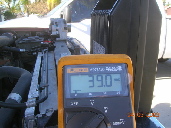

About 15 miles from home I started to notice an electrical burning smell...looked down and noticed my battery gages slowly sinking...had just enough time to make it to the side of the freeway and waited for AAA to come out and tow me home.
So today I decide to dig in and see whats going on...(charged one battery overnight) the damn thing fires right up...but I go ahead and stick a volt meter on the charge wire coming off the alt...
I don't think this is normal?
Hi rpms
low rpms
this would be the second time my powermaster alt has gone bad....

Yeah something isn't right at all with the alt.

voltage regulator shot i would guess?
I would see if you can't grab another regulator and see if that fixes the problem just to have a spare.

votage regulator went out on an old 72 dodge dart I had. wasn't aware at the time, had just bought the car, and kept cranking on it... blew the top off the battery.
power master does not use a normal regulator, I would most likely have to buy it from them...

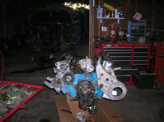

the bracket is what came off the donor 351 that I swapped the serpentine stuff from...the powermaster alt was originally on the v-belt setup and fit right into the serpentine setup.
Pics of the Powermaster? I might be able to rebuild it for you on the cheap, and make it last.
any pics of the setup Tim? There's got to be a way to fairly easily modify that bracket to accept the larger case. Is the wiring any different? Wouldn't think so, I know swapping from my small case 95A to the large case 200A the wiring was identical (but that's on a '95 side mount that also requires no bracket mod).
it appears to be a one piece bracket with the tensioner built in....
