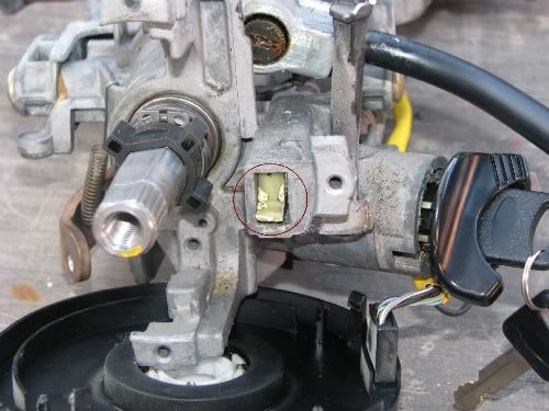

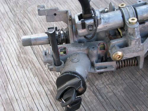

Discussion Starter · #18 ·
Here's a pic of the rod I'm trying to replace...it's the yellow plastic thing. Anyone know how much farther in I have to go to get it out?
I know I have to take my cylinder out, I just put it back in to see how the thing wasn't working.

I pretty much know that it's this little actuator, I just don't know how to get it out :doh0715:
