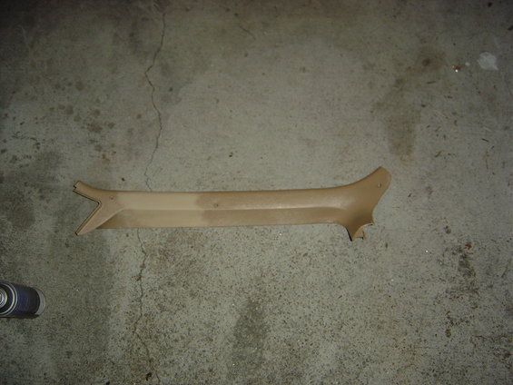

Ok, I painted the test piece.
It's a tan A pillar molding I am planing on trying to graft a generic gauge pod onto at some point in the future.
(Don't want to ruin the original in the attempt)
So since it has to be red one day anyway, might as well use it as a guinee pig before I spray this stuff on my door panels.
Prep:
I cleaned the entire thing with purple-power twice. Then I lightly wiped it down with acetone. Then, just to make sure the factory paint did not cause a problem I wiped a section down with acetone until the factory coating was removed and it was down to the bare plastic. This is the lighter area in the picture below. Unfortunately this did lighten the texture a little.
Took 5 mist coats to cover. The area with the factory paint removed was harder to coat, making me think it was sinking into the plastic, but sat on top of the factory paint everywhere else. Then again it may have just been the fact that that area was lighter.
Well it definitely looks like something that belongs in my Bronco :toothless
I'll give it at least 24hrs to cure, then we will do a few scratch tests to see how it holds up. :thumbup

I let the Color Bond cure for 48 hours and then did a scratch test.
I can not scratch it off with my fingernail anywhere and it takes a serious effort to scratch it off using a penny.
(I'll post some pics of the results later)
I have painted a few plastic pieces with duplicolor interior paint/die and Krylon fusion and was never impressed with the adhesion, I am much more impressed with the result's I have obtained in this test with ColorBond. :thumbup

Did you notice any difference with the portion that you fully stripped down vs the rest? In other words, does one need to completely strip the factory color off? What did you use to prep it with? I mean, I know purple power and acetone, but with just a rag?
Wow, that's great looking. Not bad!
Yes, just a rag and water to wrens with.
Ok, here are the post scratch pic I promised a month ago :toothless
(Click thumb for pic)
If you look closely you can see a chip missing from one end and a crack in that same end. It got well abused after it was painted to test the adhesion of the ColorBond.
