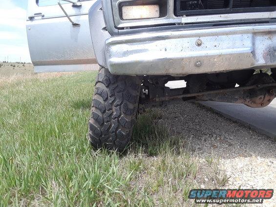

Front shocks happened yesterday. The stabilizer shocks we’re still good , just ugly. So I cleaned them up, painted black, and put black boots on them. Looking good. Driving even better. Eliminated nearly all of the wander. Can see some slop in the pitman movement so that will probably be the next mechanical project in 2 weeks.

Might look into that later. Just trying to get it running and somewhat reliable right now. Still have oil leaks everywhere. But it does have some bad bushings making the front end pop while turning, so looking into that may come sooner rather than later if we have to tear the whole front end apart anyway. Thanks for the recommend though. That’s exactly why I’m on here. I know lots of you have already researched and tried different solutions and found what works best for these trucks. Saves me time, money, and grief!

Popping when turning sounds more like ball joints than bushings to me...
That’s what we thought too. But when we had the front end off the ground after putting on the new shocks, we were able to get it to pop and saw that it’s this joint behind the front diff. Ball joints are all tight and look like they have been replaced. Not recently, but not too long ago.

Axle u-joints will do that too.
So will overtightened spindle nuts at 75 mph...
