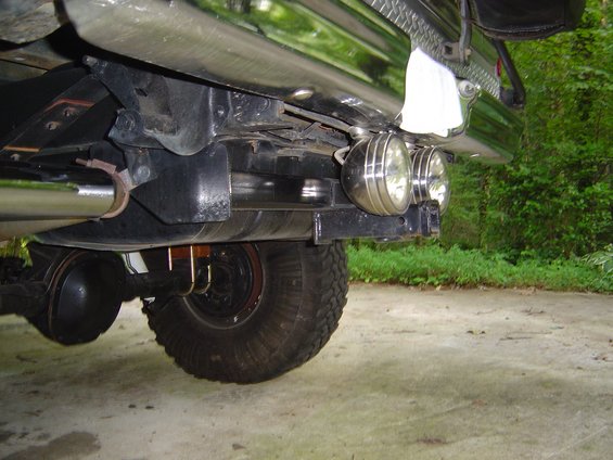

I have two KC Daylighter (pencil beam) long range driving lights mounted under my back bumper for use when backing up in unfamiliar, unlit, places.
These lights where not purchased for this purpose, they are pencil beams and poorly suited for this use. But I had them laying around not being used, so I decided to put them there. And for nearly 10yrs they have been hanging outback. The cases are the expensive stainless steel units, so no rust ever, and I think they look cool the way I have them.
But they suck as backup lights.
Recently I came to an epiphany....
I don't have to use pencil beam bulbs in them :doh0715:
Any bulb for any 6" KC-Daylighter (and many other brands) will work. :chili:
So, do want regular driving light bulbs? (Not long range pencil beam)
Or Flood light bulbs?
Normally I would default to flood, but I wonder if all the angles in that diffuser will spread the light out to much, or is that what I wont?

Flood light all the way, but instead of putting 2 in the middle of the bumper where 1 will do the same job, either point them outward a bit or spread them out. If you spread them out, you not only light up diectly behind and light up the sides of the trail on both sides, but you also get the added bonus of nailing both the driver and passenger of the tailgater bahind you.:thumbup
They are pointed outward slightly (can't tell in the pic)
Well it looks like KC has stoped using sealed beam bulbs in daylighters. They are using a lens-reflector/H3 bulb combo.
That means I'll nead the following.
100w H3 bulbs $9.79 x2 = $19.95
http://www.kchilites.com/store/Bulb-100w-Clear-H3-Halogen-P131C27.aspx
6" Lens / Reflector Flood $28.69 x2 = $57.38
http://www.kchilites.com/store/Lens-Reflector-6-Rnd-Flood-P195C74.aspx
Total = 77.33 (plus tax, plus shipping)
Thats way more than I am willing to pay.
Any ideas on how to do it cheaper?
You know, I think my Harleys headlight is a 6" sealed beam.
Mmmmm, that might work.
Confirmed.
The Harley bulb (same bulb my 72 C-10 uses)`will fit the housing just fine.
They are driving lights so they will spread the light out much better than the pencil beams.
I will buy 2 of them sometime in the next few days. They are about $5.00 each.
May not be as good as a flood, but it lets me use my fancy stainless steel housings. :thumbup
