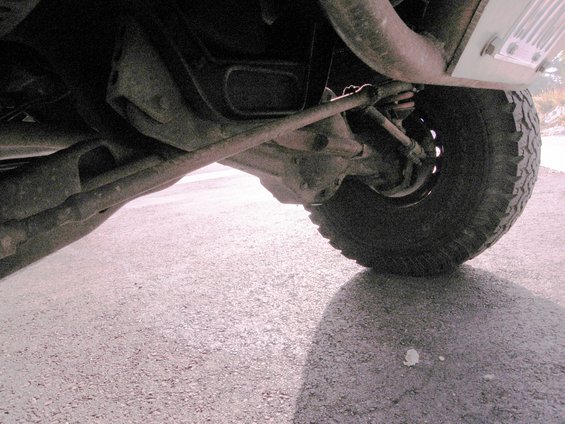

Hey Randy,
Yes they are, see pic below. Crappy pic but you get the idea:
Just a thought running in my head. Wondering if a TRE flip would be beneficial to the steering? Maybe 6 of one, half dozen of the other???
I suppose a johnny joint style end would be more ideal?
Your thoughts?
Your thoughts?
I've wonder the same thing Tom. Though I have a lead on an Autofab swing set steering kit that I think should solve any bumpster. Though I have to say that I haven't felt any bump steer in this 84 Bronco.
I only am asking here as I once again am trying to get more serious to building my rig again this winter. I have more time now that I'm not working a 8-6 job. Time to sell it or finish this project.
I think the swing set would be the better option than the TRE flip.
I'll probably "borrow" your photo and ask in other circles if you don't mind me doing so...
No problem Tom. I'll have better pics next week. Any thoughts on cross over steering Paul, Brian, Steve, Mark, others?
Flipping the tie rods would create more bump steer with stock pivots.
Why?
Your changing the geometry when you move the outer rods up or down with stock pivots. You want the tie rods and beam to be parallel during travel to reduce bump steer, flipping the outer tie rods causes them to be less parallel.
Ha - you shouldnt have asked. But here goes.
I have stock steering with no issues to describe. 18" of travel.
Chris has bent 2 tie rods and decided to ignore the fact that the HD unit described in another thread did not bend he had gwent to a ram assist custom crossover built and designed by Glen. It looks beautiful and is very expensive. Result it steers easier and has no bad things to discuss - Just like the stock setup. However with all heims and heavy 4130 tubes it has to be many times stronger.
Kurt has the first generation crossover setup by Glen and he is also happy.
Both Chris & Kurt drove many thousands of miles with the stock setup before deciding to do the upgrade. Maybe if I start driving as hard as Kurt or Chris I will start bending or breaking stuff and will re think the issue? All three broncos have the same front setup, beams, arms, shocks, towers, Heims, & travel. I think Kurt has 37 projects and Chris & I have 35 Bajas.
I have Chris' album and need to find time to post the eye candy for his latest reincarnation of Ol Yellow. Later when I figute out Super Moters.
Lots more important details to resolve thatn a new steering design. Mine has issues again. To many miles and to little attention. sigh.
Paul
7
Many Baja miles and no problems with this set up, 1.250 x .250 4130 tie rods with 7/8" hem ends. If you are going to drive hard and don't like being stuck in the boonies, it is a worthwhile investment. IMO, the reason for going to swing set steering is for the strength. The stock set up works well until you hit something wrong and bend the rods, the bump steer improvement is insignificant.
