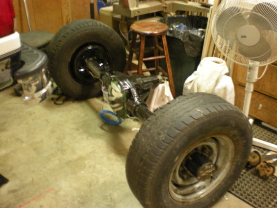

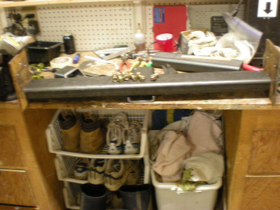

heres the meat, stripped, cleaned and painted except the tubes
Parts, rebuilt my calipers, sand blasted, and painted all my parts
35 Spline Outers + new u-joints :rockon
Upper Coil buckets/ retainers, lower coil cups, radius arm cups, sky shackle flip brackts.
Lower Track Bar mount, going to add gussets to the back side and inner side.
Tranny Cross member
Thats all for tonight, im going to try to finsh the x-member tomorrow

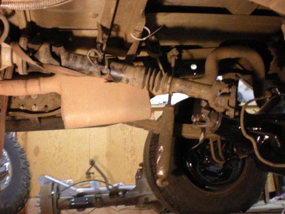

is that added little bracket on the axle trackbar mount going to be for the hydro assist then?
you got it. im going to wait untill i have more cash to accually get hydro, but i thought i might aswell set it up now
Master Bater
7,268 Posts
you'd better wait to burn it on then. There isnt much clearence when at full lock on my 90 KP, not sure if the 78/9 axles have longer steering arms or not, but the tie rod pivots in and out. Its out furthers at center, and closest at either full lock. The other issue then becomes that the rams are 8" stroke, which means the mounting bracket on the tierod will end up about at the diff, which will leave very little room.
if the track bar mount was going to be more on top of the tube, it would work better, but it appears you are going to put it forward????
good point man heres some clearance pics. i think im going to have to move it more towards the top like you said. or just scrap my hydro untill later.

I would have liked 5.13's or 5.38's too but my C6 already has me running at 2900 rpm's at 60 mph with my 4.88's. I would wait on the ram mount. I finally have mine where I want them to be on the third try. You need to have all the parts ready to check for clearances before you get ahead of yourself.

yup i decided to scrap the ram for now. im going to grind it of tonight.
