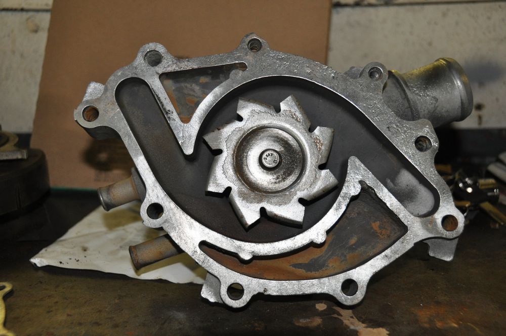

Cleaned up the water pump, a bit pitted but still in usable condition.
Oh but big surprise, the gasket set doesn't have the right gasket.
Did manage to get the timing cover on
3
looks like if you flipped it over and rotated it 180* it would fit. Sometimes they look way off but if you manuver them around a bit you find they fit.
Edit: now that I look at it it looks way too small. but still give it a shot, mine looked way off till i played with it for a couple minutes.
LOL, its the wrong one, I have since got the right one and have installed the pump.

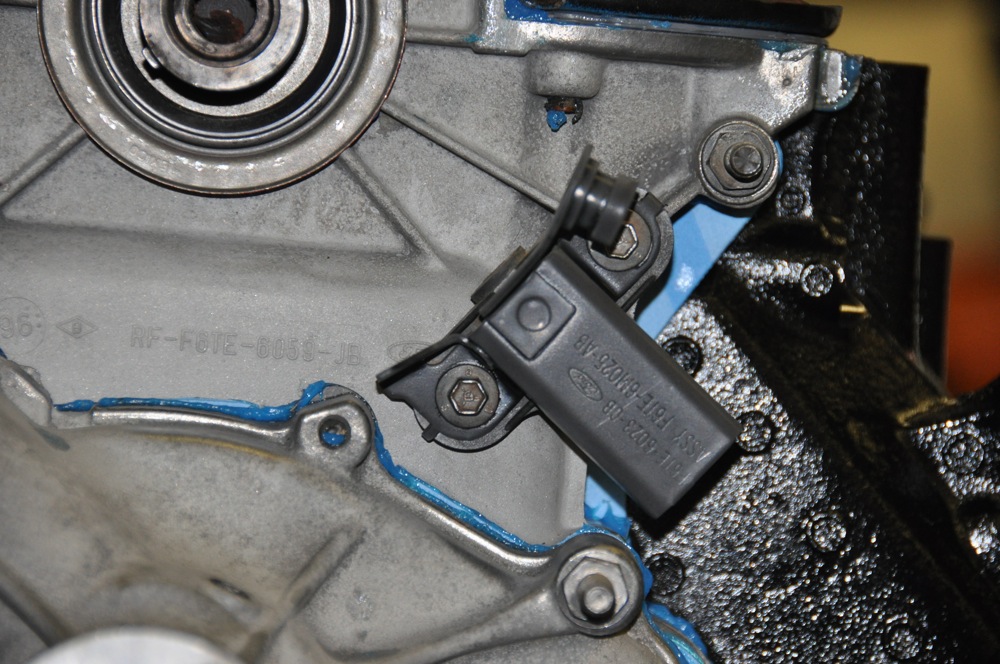

Installed the crank sensor

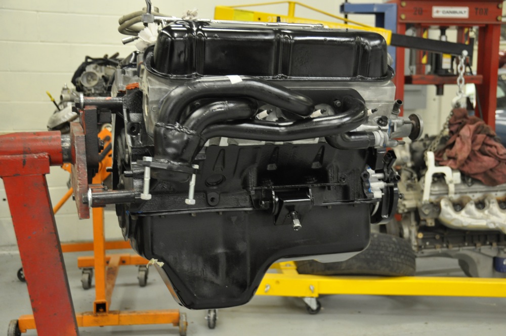

Installed the motor mounts but I had to grind away the drivers side to make it fit flat, I'm not impressed.
You can see here where it hits the block on the 90 degree bend, I'll have to weld a bead on the inside to restore strength.
Cleaned up the balancer and installed it.
More pics of the mounts

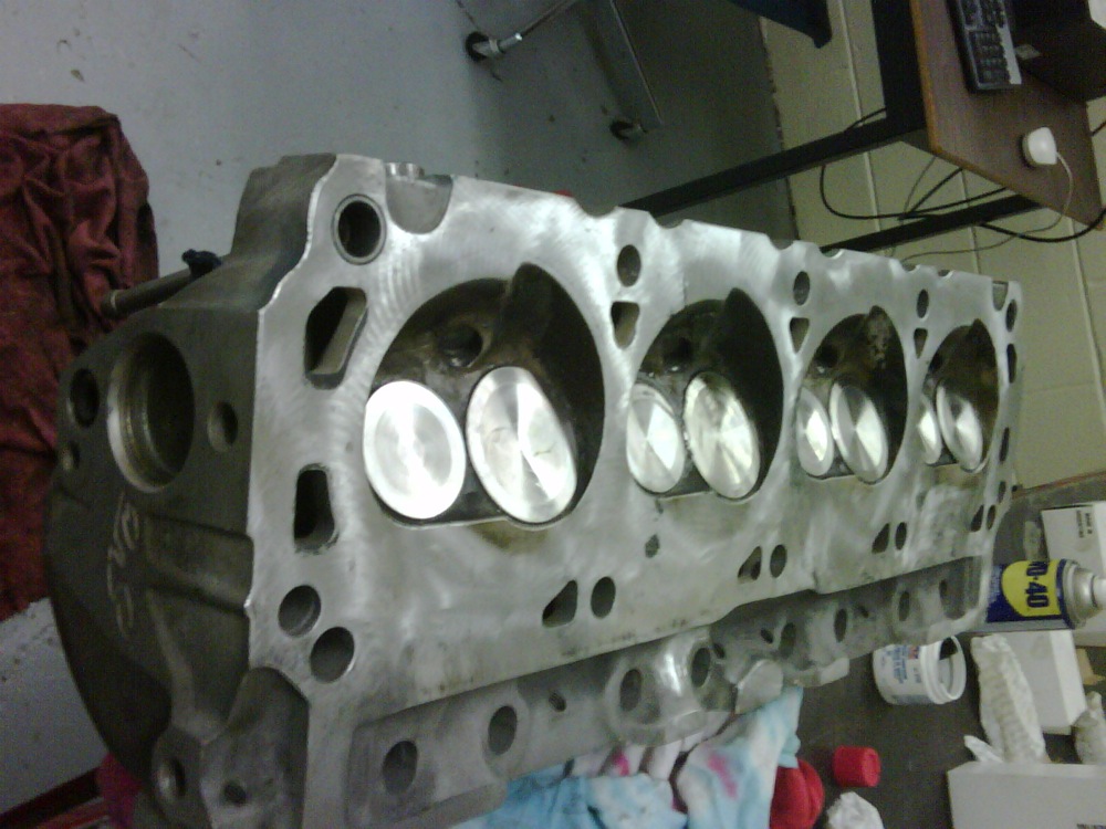

Installed and lapped the new valves
Installed the heads

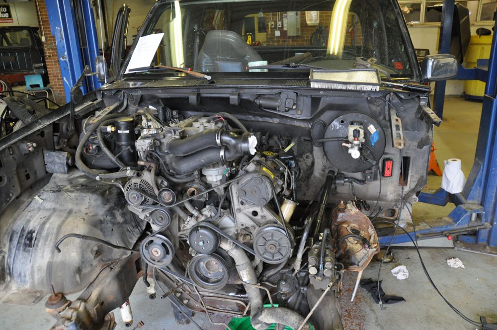

The day has come.... transplant time!
Started taking out the old engine this morning.
