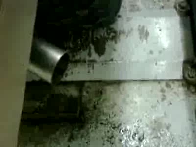

The exhaust must have settled with the heat running through it and now the tail pipe is banging off of the tank skid plate, drives me crazy! So I'll be fixing that real soon.
