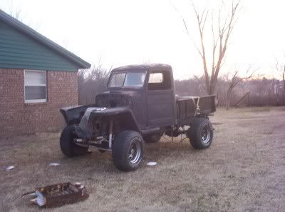

Okay I bought this truck today and was told it was a '78 or '79 Bronco chassis. It's got a dana 60 rear end I believe, that was never available on a bronco right? I don't know what front diff is in it, but it's 8 lug drum. The guy told me the motor was a 460, 460's and 8 lug front's weren't available on a bronk. So maybe you guys might have a better idea of what this thing is? Here's some pics and some more questions, thanks in advance fellers.:thumbup
Any clue what year this cab is?

Well if they went through all the work of putting the cab on there I'm sure the motor probably isn't orginal. The axles could have easily been swapped in too..

BrokeCuzWheelin said:
That is freakin sweet. Where the hell to you find these deals?!?!?!?
That's a late 40's Willy's. A friend of mine is in the process of swapping a '48 Willy's cab and bed on to his 83 1-ton Chevy.
I got this from the same guy I got the CJ-5 from, he is a has a endless supply of shit.

thats a 1947 willys truck. prolly a low pinion, drum brake 44 from like a 75 or so f-250 along with a dana 60 rear 16 or 18, its the sucky gay coarse splined one.
