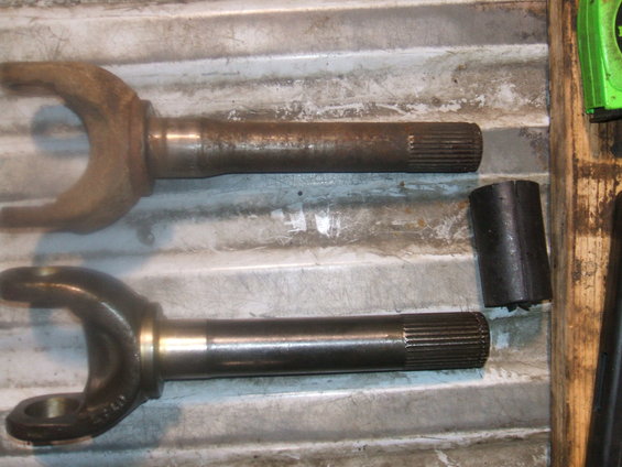

Results of the last run of '07

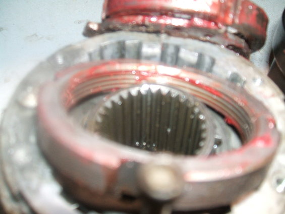

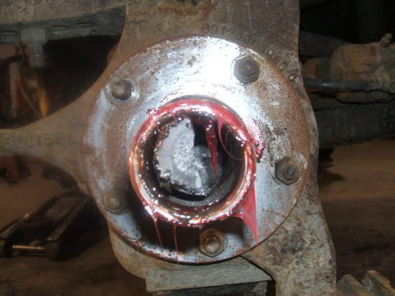

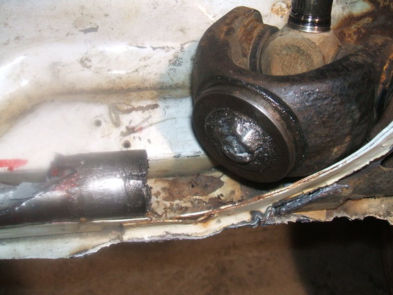

Hard to tell but the hub is split inside.

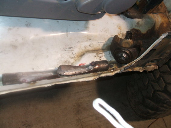

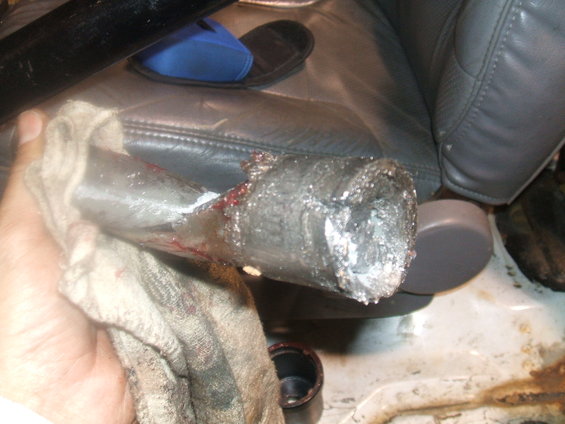

Easy to tell, that axle is fubar

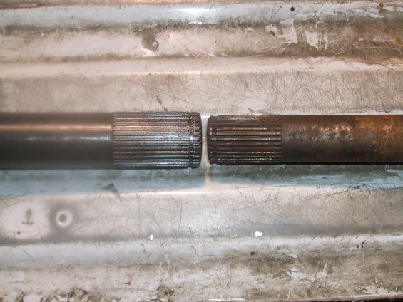

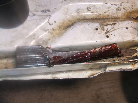

Whoops, broken in 2 places. COOL!

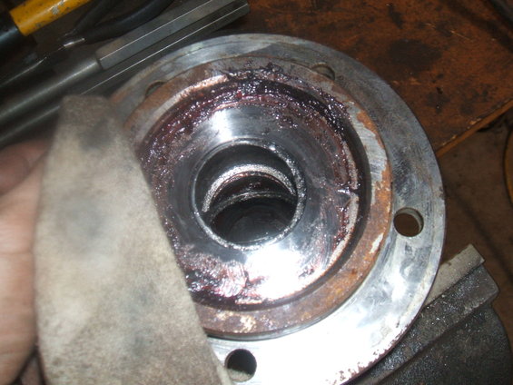

Let's not forget the bearing inside the spindle.
Those were 30 spline outers.
Upgraded to 35 Chrome molys from Randy's

im running the 35 outer chro mo's to. so far , no problems.
you did a nice number on those 30's.

thats the biggest issue with the 30 spline stuff, they are fairly tough, but when they let go, they take the spindle and hub with it. Many times, the shafts will mushroom, and the spindle is a mother to get off.

You're not kidding. This is my 3rd broken outer. (someone gave me 2 spares) All three split the same way. 1st one did the hub, 2nd killed the spindle just like that. I'm very glad this one resulted in just a bearing, and not the whole spindle replacement.
