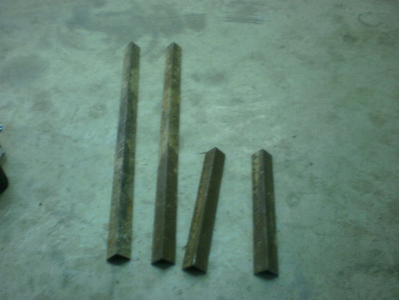

I got tired of killing myself leaning over the side of the bronco. The step stools that I had and the front bumper just wasn't enough any more. I had seen one of these in an add before but for smaller trucks with smaller tires. I had been wanting to make one of my own for a while now and wrenching on the bronco the other day was the straw that brooke the camels back.
2-31" and 2-13" 1 1/2 angle
tacked in place, the outer angles are at an angle to match the tires tread pitch
angles for the step 1-31" and 2-24"

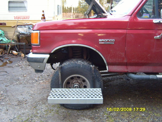

all welded together
3 2x6 boards fit ok
2-24" kicker legs
side view
front view
I put a leaf spring on the bottom of the kickers to spread the load across the tire.
It worked out pretty damn good to, it puts me right up there in the bay so I can easily reach about anywhere on that side. Its not all that heavy either, all the angle is 1/8" to btw.

I like those walt they definately look lighter than the ones I made. I realy didn't need it to be that big but I figured whats it going to hurt to have some extra room to stand. I dont realy need one for the front with the giant winch bumper on there.

Thanks, I didn't think you needed one for the front of your rig, but I figured someone else who is handy with steel might get some ideas. I posted pics of it when I made them but it was in a different section.
