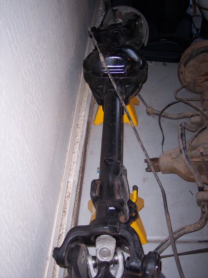

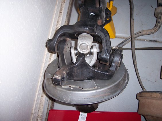

D60 out of a 94 F350. The axle outters are pretty much rebuilt. The rotors are used and it does not have calipers, pads or hub locks. Other than that, its good to go. My plans for the axle itself are to pull the hubs and have them turned, purchase new calipers, pads and hub locks. Then, I plan to strip the paint, rust bullet it and either herculine or paint it.
Here she is just waitin:
Lil Closer
Outter - All Spicer
Close up of the dif:

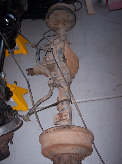

Here is the 60s partner in crime - Sterling (this thing is gianormus)
The sterling is gonna get the wire brush, rust bullet and herculiner/paint as well. I think I am gonna probly rebuild the drums on it for now and maybe look into a disc conversion in the distant future.
Here are the pair:
I picked them both up for $1200.00. Not too bad I dont think. Both appear to be in great shape and a lot of work has been done to the 60 already.

Yeah I was suprised at how big that sterling is! It's huge! I just set one under my 80 f-250.

Damn those are clean. Just tell the Girl friend youll buy her something and she leave you alone. Thats what i did

Ouch we had an engine hoist when we loaded my dana 60 and sterling. Then we just lifted the 9 inch and dana 44 on top of them. I unloaded all of them myself using an engine hoist.

i wouldn't bother repainting that 60. it looks perfect from the pics. my advice for the sterling is to have it sand blasted. i didn't and spent WAY too much time getting it as clean as i wanted it to be. it would have only been 40$ to get it blasted and that's very worth it. make sure the yoke on the sterling matches the gears you get. ditch the factory shock mounts. there's nothing like the peace of mind that comes with a D60.
jam0o0 - I was considering the repaint on the 60 only so I could rust bullet it. Thanks for the advice on the sand blasting. That sounds like a good idea and for 40 bucks, if I can save 2-3 hours, it would be worth it. Now I just have to figure out how the crap to get it back into the truck :doh0715:
I need to keep my eyes on the CL and pick up an engine hoist. Oh, and I agree with your last sentence 100%. Thats the only reason I went 60 over 44. I just like the idea of knowing if I need to get on the skinny pedal when on a trail, I can do it without worrying much about breaking something. I had a 44 and decided to sell it and go with the 60.... I figure by the time I get done beefing the 44 up, it would be close enough to the cost of the 60 to justify spending the $$ on the 60 up front. Plus, I can make the 60 stronger as time goes on... if needed.
