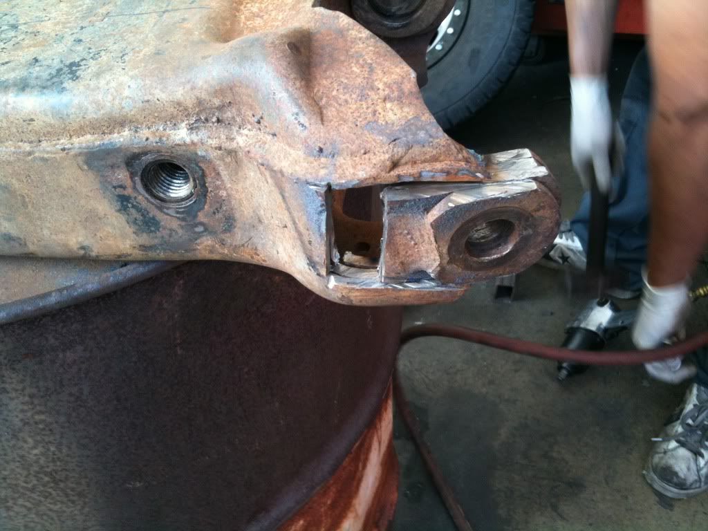

I have done a few cut and turns now for friends and my bronco now I am going to do a 4" wider. Once I am done widening them I will put them on my jig and cut and turn them. I did not have too much time yesterday I got the p/s widened but I still have to plate the front and back of it and cut and turn it. Once they are done I will have new axles made.

Nice bronco too!! Noob question but when you turn them are you cutting them at the knuckle end to do so?

I cut the and move the lower ball joint out like the third pic shows then I plate it all in

I will get a picture of them after they are welded I would not do them off of measuring. I would only do these in a jig

The driver and passender side "turn" is different so just saying 7/8 would be bad. I made a jig very easily which usues the knuckle and beam end to make sure everyhting is correct and I use 0deg cams with the jig that way its dead on for camber in the jig and then you have a couple degrees of adjustment with the cam depending on which one/type is used.
Im diggin these so far! I had to double take becuase they look so much like the ones i build in the beginning stages. Welding looks superb! Very nice to see someone who knows the value of a good weave pattern. Too many people are trigger shootin these days or "loop and swoop" or whatever they call that crap. Keeping the heat in the joint and not doubling back means 100percent root penetration and less or no inclusions. Well done sir! too bad so many others dont understand this

TY for the clarification. Still new to the whole cut and turn concept on a TTB, much different than the cut and turn i'm use to doing on a VW bug front end.
