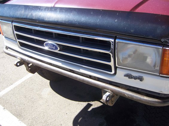

This bumper took about a year to get to where i'm at today. Every other month or so I'd get a couple of hours to work on it and then it would sit. Now that's it's almost done I figured I'd share
going for something like this

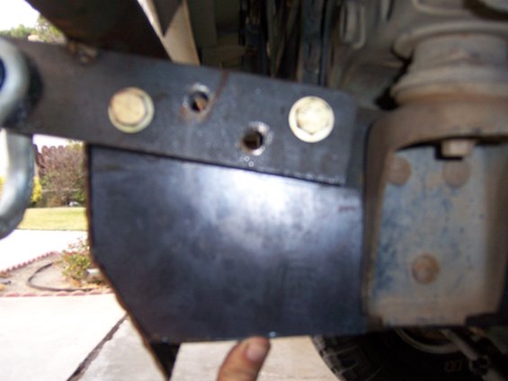

Shackle mounts

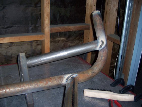

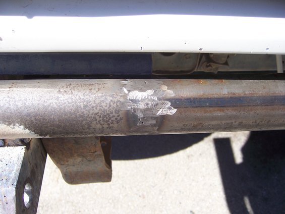

The bend was a touch off so I had to re-clock the tube using 1-3/4" DOM as a slug
Front bull bar tube and also the ends of the lower tube are capped

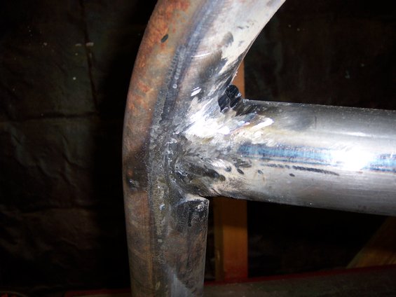

Exposed weakness
No more
Plating the sides for more surface area to mount tubing to
Some added strength to the outside corners

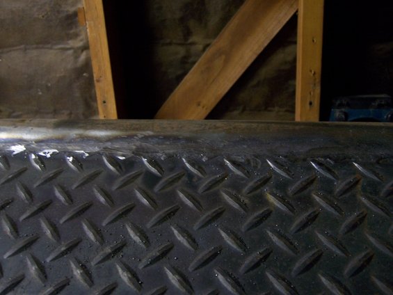

I built a welding table big enough for the bumper to sit on comfortably.
Then started with welding and clean-up
Adding some more diamond plate

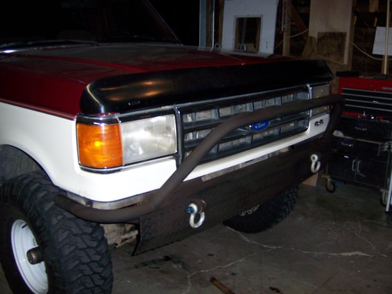

Pretty much all cleaned up at this point

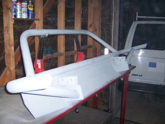

Primed
and painted

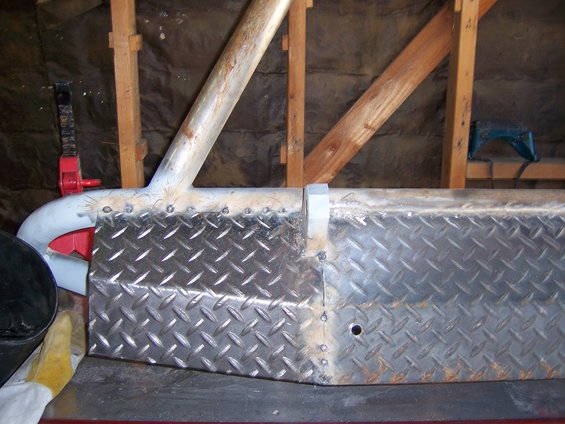

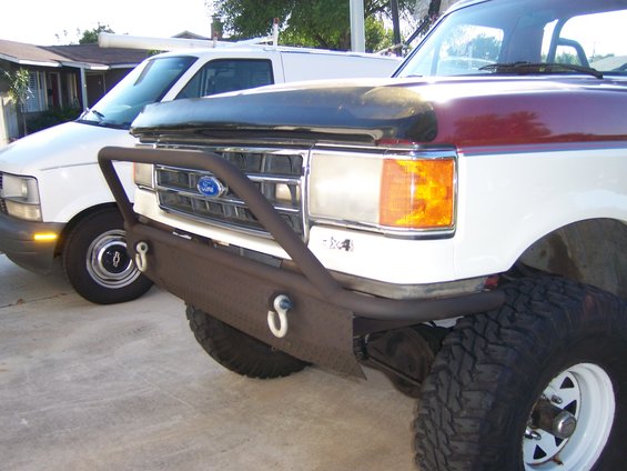

Iv'e gota good amount of feedback from friends and they think the corner diamond plate hangs to low. The also said that they would like to see the diamond plate go all the way out but that's not really feasable with the tube bending before the edge. The diamond plate would have to be arched and I don't think I can make it look good enough to put on to the bumper.

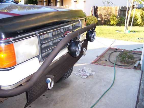

Also, It's time for lights! I have 2 6" ones but I'm having trouble figuring out what to do with them. Here's some options
And here's if I got 1 more

Nice bumper. I agree to cutting the corners off of the diamond plate.
I say two lights on the bumper maybe closer together.

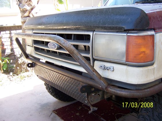

thanks for building it... I was wondering what that style bumper would look like on mine...
The problem really was that I started a year ago wanting a tube bumper and then twards the end I was looking into a boxier style bumper. I merged the two and this is what it came out like.
This is what the front bumper could look like when it's trimmed.
Thanks for the input. Keep it coming.
3,634 Posts
Yep. You should trim right along the angled tube on this side.
That piece of plate will get caught on something while backing up and bend
anyway.

It looks pretty good though. I think the checker should at least taper up to the end(sides) of the bumper to finish it off.
WOW! I don't even see the seem on the left side, what did you do, bend it the opposite way?

This is a nice bumper, just wondering if you ever fixed the outer diamond plate? i think it would be nice to see it cut at an angle and perhaps then you could extend it out more. Definitely on my list of things to copy and modify :toothless If you dont mind :beer
