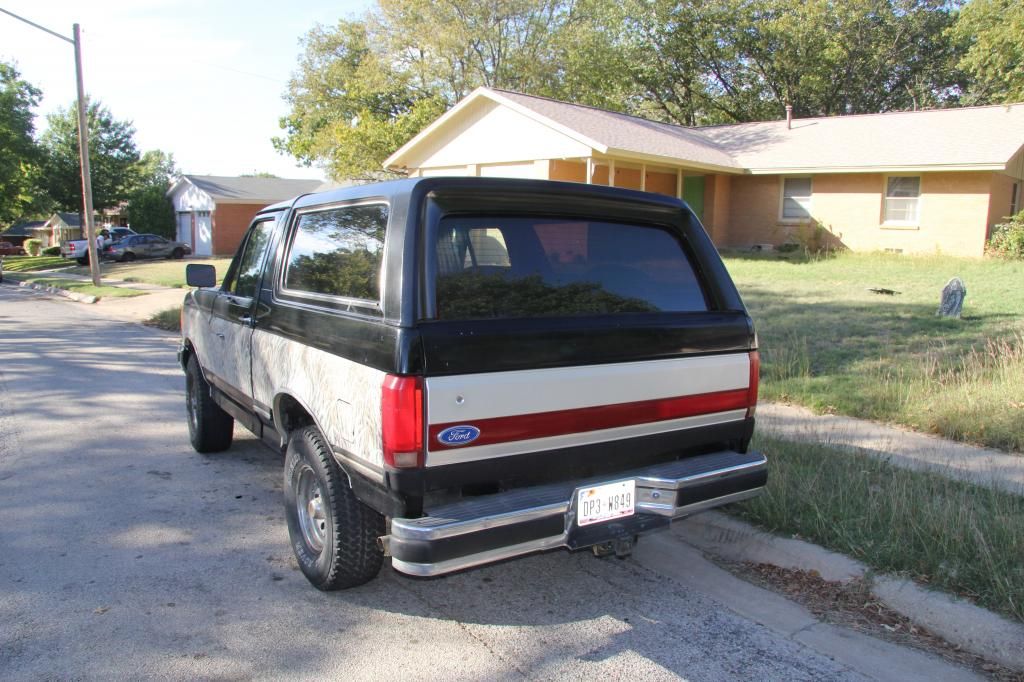

The Camo-Pig is a work in progress and here's where i'm putting my directory for all of the extra stuff i'm doing to it.
Here's how it looks as of 07/2015
Here's how it looked back when I I picked up this beauty for about $3,500.
It starts and runs beautifully, every time. It doesn't have any rot rust, just some surface rust. It belonged to a cop and he took it out to his deer lease. So some of the frame and undercarriage has a little play in it.
It's all stock for the most part. It's leaking a little bit from the transfer case
I think the front diff case is leaking too. But it could just be scummy.
