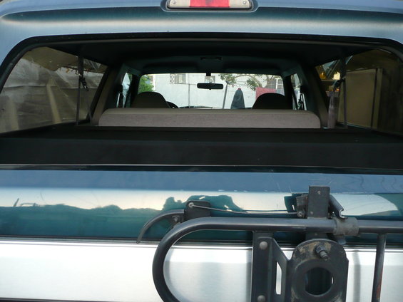

Well I know a lot of people want the original cargo cover but their either long gone or not for sale. I made mine. Not much to it, 2 yards of felt, heavy duty velcro from HD n some spare wood. Its not original but it does the job. Plus its really not that expensive total $15. Well if anyone decides to borrow the idea or make it better post pix here. Assuming you dont have the original.

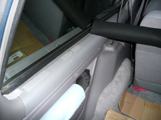

How did you mount it, any pics of that?

Fartman its simple attach the felt around 1st piece of wood. Staple it or nail it its up to you. Place velcro on top of trim of both sides. Then set it n unfold. Hope picture helps out.
