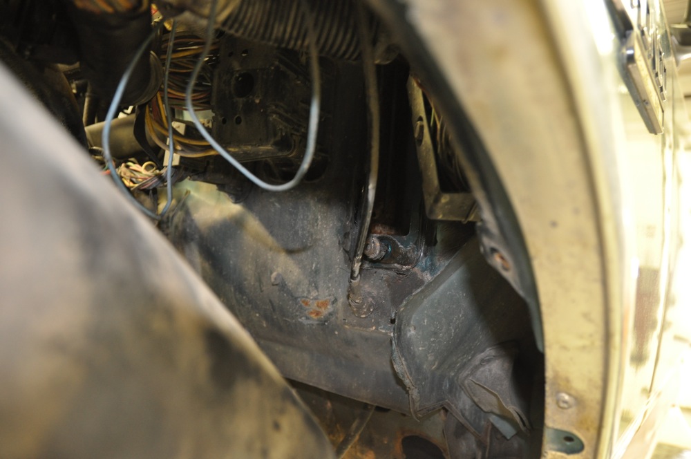

The best way to do this is through the drivers side wheel well by loosing off the plastic inner fender as shown

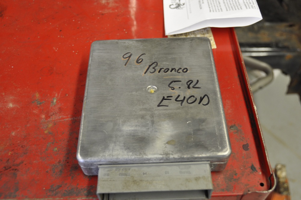

I label all my computers when I remove them so I didn't get them mixed up.

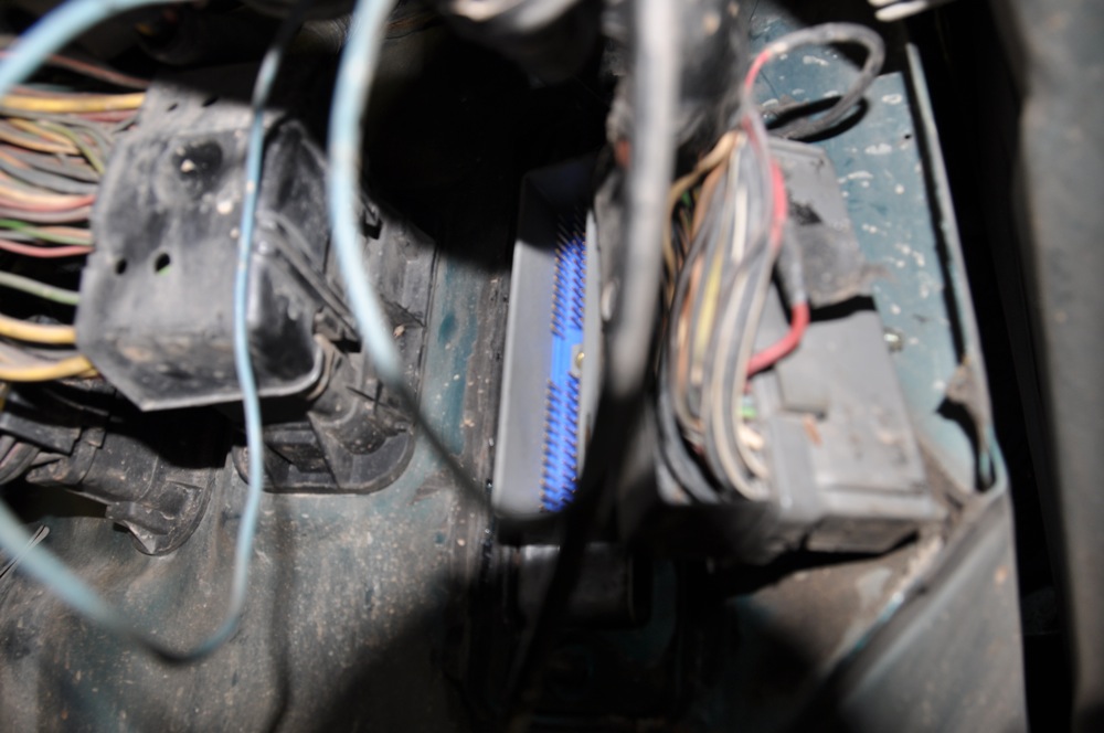

Pulling back the plastic inner fender you will have access to the computer harness, this requires a 10mm socket to remove. Next you remove 2-11mm nuts on ECU rubber gourmet, remove the grommet and pullout the ECU. Here the ECU is already removed
Slide in the new ECU

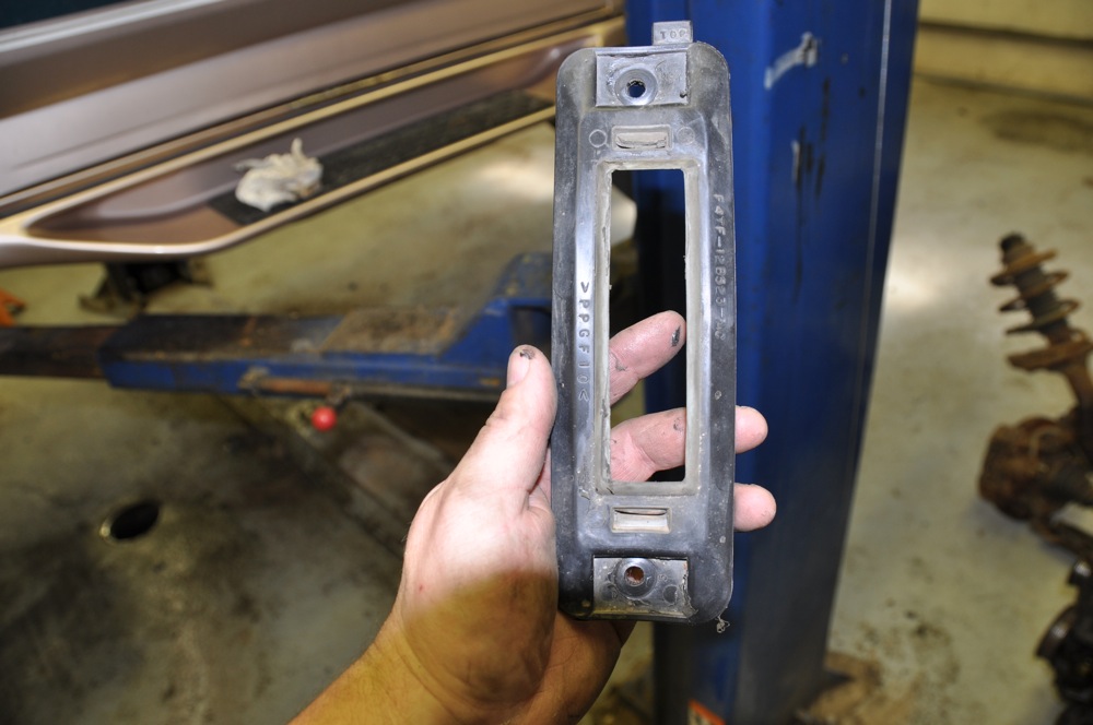

The rubber grommet, notice the marking for "top".
Reinstall the grommet, nuts and tighten down the harness and the ECU is installed.

*EDIT* Bossind...did you also write down which model of computer you have? You may also need that information for certain things. That number is on the plastic pin connector housing. This one is a C3W1:

Tried it Bossind's way and it worked perfectly for my 94 with a 5.8. There wasn't a good way to pull it out from the top with the rubber seal and the plastic splash guard in the way.

Just to add bit more detail. In my 94, the inner fender bolts are 5mm, I used nut driver in drill to remove. I had to remove front running board mounting to gain access to bottom inner fender bolt. So, check for open end 5mm wrench, my kit stopped at 6mm.
