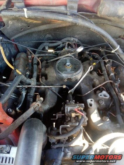

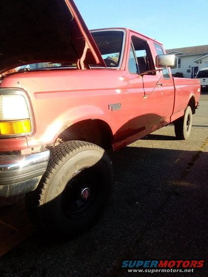

Did some work on the red parts truck today. Started it again and pulled all 8 injectors. I'm taking them to a diesel shop tomorrow to have them pop tested/rebuilt if they need it. Demand for these trucks is pretty high so once we get it going should be able to flog it pretty easy. Also found out that the crappy feeling in the clutch probably has something to do with the huge slop in the pedal assembly.

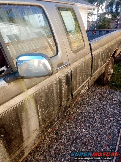

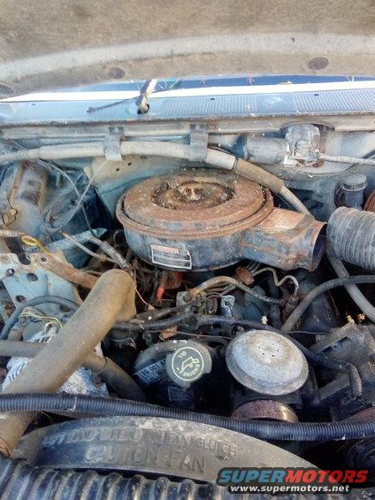

Now onto my truck. She's in rough shape body wise but the engine is a lot cleaner, ie less oil and diesel leaks. I'm probably not going to do too much to this truck until the red one is sold.
