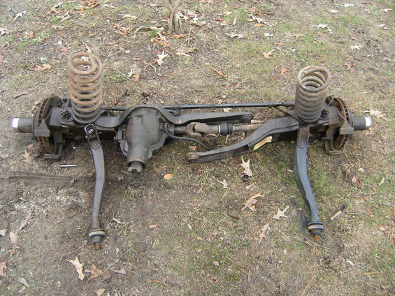

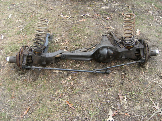

Well, I finally got a donor axle to rebuild for my truck. It is out of a 92', just like mine. Got it complete from hub to hub for $150. Could have been had cheaper other places, but I would have had to drive to get them. This one was right down the road.
BEFORE YOU READ ANY FURTHER- I have no interest or need in doing an SAS right now. Don't have the time or the tools either. This can be done on my own time and swapped straight into the truck when we do the lift.
I plan on swapping the rebuilt axle in when I do the Rancho 4 inch lift, hopefully in the spring. I want everything in the front end to be new.
THE PLAN:
Completly tear down the axle. Take a wire wheel and sandpaper to all painted surface. Repaint everything.
Starting from the outside in:
-New Warn Premiuim hubs
-New inner and outer wheel bearings, races and seals.
-New brake rotors
-New brake calipers
-New braided stainless brake lines
-New spinde bearings and seals
-New balljoints
-New axle shaft u-joints
-Change diff fluid and inspect stock gears for wear/damage
-New axle pivot bushings
-New steering components
I havn't decided yet on the D50 slip shaft yet. There aren't very many availaibe around here.
Keeping the stock gears and open diff for now. They will be changed to a Detroit Tru-Trac and 4.56s at the same time the rear is, when I upgrade to 35s in a year or so.
Also adding a drain plug to the diff while it is out.
That should just about cover everything. I want the axle to look brand new when it goes back under the truck.
Here are some pics of the axle after three cans of degreaser and about 30 mins with the pressure washer. Should start the teardown tomorrow, I will post more pics after that.
Any sugestions are welcomed!:thumbup

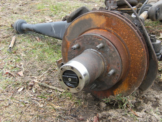

Got a little bit done today…
PART 1: Brake and Hub Removal
NOTE- I am doing this teardown with the axle out of the truck. If you are attempting it with the axle in the truck, first remove the wheel and tire and brake caliper. Set it out of the way and make sure it isn’t hanging from the brake line.
First things first, the tools you will need:
-Allen Wrench to fit your hub dial screws (this will differ with make and model of hub)
-Snap Ring Pliers
-Set of Dentist Picks
-Spindle Nut Socket
-1/2” Drive Ratchet
-Pry Bar
-Latex Gloves
I also have the 3/8” drive sockets and PB Blaster pictured, but they will be used in a later write-up.
Step 1: Remove the 6 Allen head screws that hold the hub dial to the locking hub itself.
Step 2: Insert the pry bar behind the u-joint where the axle shaft and stub shaft meet. Push the axle outward to provide access of the snap ring.
Step 3:
Remove the snap ring on the axle shaft.
Step 4: Using the dentist picks, remove the retaining ring in the groove of the hub.
Step 5:
Thread two of the allen head screws back into the locking hub and remove it from the hub.
Step 6: Using the spindle nut socket and ½” drive ratchet, remove the spindle nut.
For whatever reason, the driver’s side spindle nut came out in pieces. Never had seen that before.
Step 7:
Remove the outer wheel bearing.
Step 8:
Remove the hub and rotor assembly
Then you are left with the bare spindle with the axle shaft in the middle.
And all of the old parts you just removed.
All I will be reusing are the hubs themselves.
This is a good time to go ahead and soak the nuts that hold the spindle on in PB Blaster. I tried taking one of them off, and it just spun on the stud. No fun.:banghead
