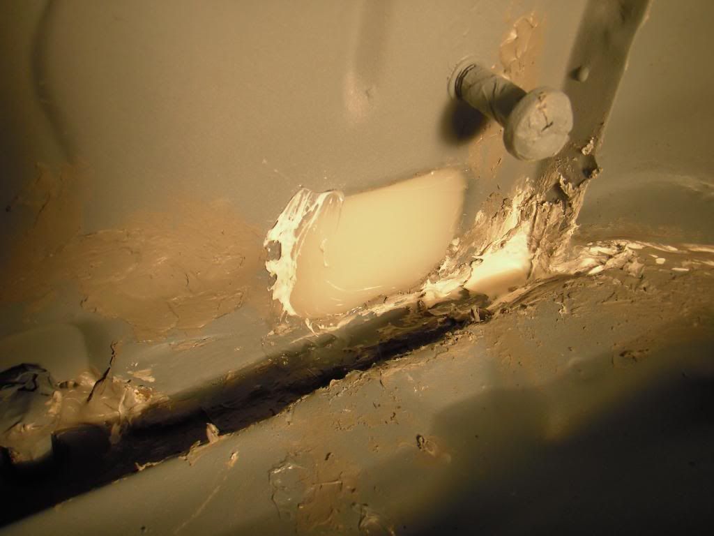

Here is where the seam sealer wasn't even on the seam and was only through the middle. The bottom was wide open.
Right side the same way, seam sealer should go on the seam, RIGHT??
