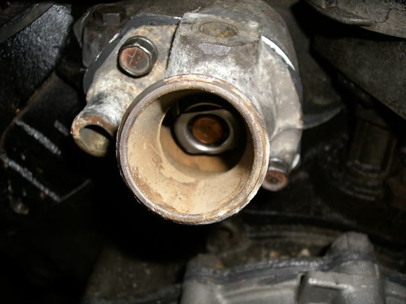

Had a long day,please tell me this is the correct way to mount the thermostat? :whiteflag

yep pointy end up.

Just remember the spring is what is activated by heat to open and close the thermostat. Therefore you want that in to the engine so it is heated by the water (the top hose is the return hose to the radiator).

exactly, and the jiggle valve always points up (if the car has one)
