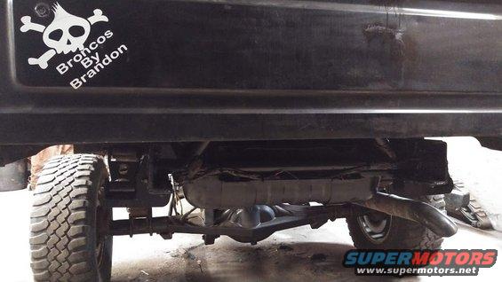

Discussion Starter · #344 ·
Hopefully last time for this job for awhile... Though only took about 4 hours start to finish. I also clearanced the lower balljoint threads a bit more for the RCV orange boots
Random Pic, Random Sticker
