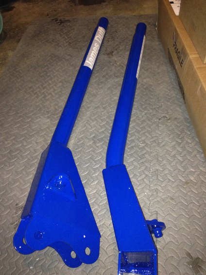

James Duff long arms

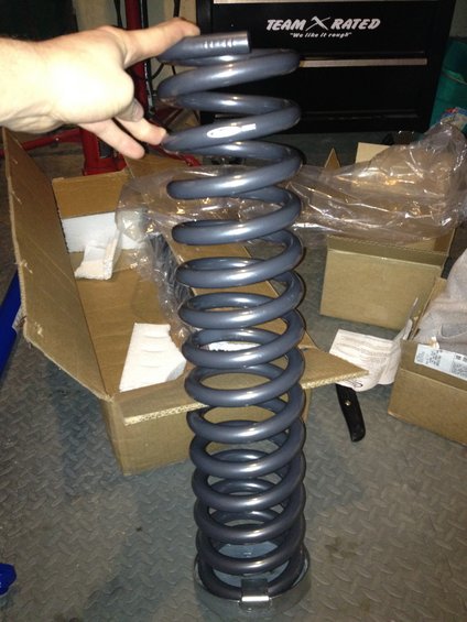

6" deaver coils sitting in the HD cups

What are you using those poly bushings for? The axle C's should get poly. They last, the should not flex, and with duff/cage arms there is another set of bushings between them and the frame. The RA arm to axle mount with duff and cage as I recall are also poly, and this is good, no issue here. All the flex really comes from the heim at the frame side.
