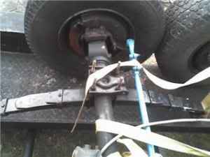

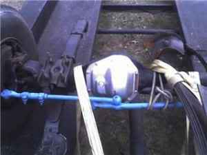

First to showoff some parts.... First I picked up a sterling 10.25, and then had it regeared to 5.13's. I'm just using the stock L/S in it for now. Lockers front and rear will come in the future. Heres a pic of the axle after a little time with the grinder.

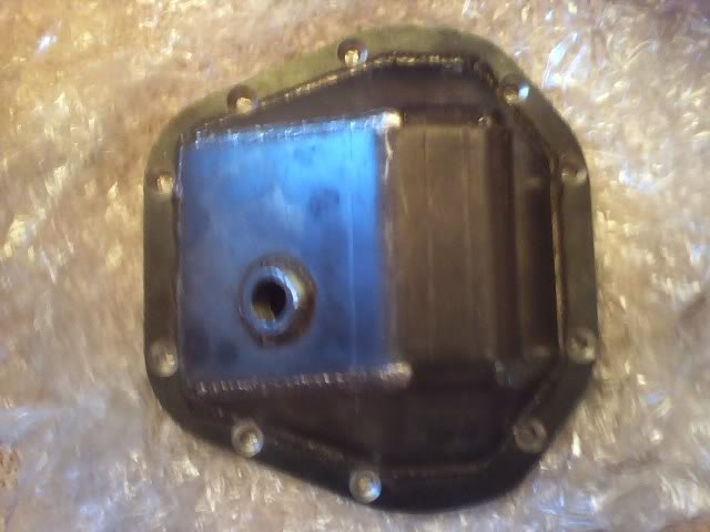

I have a diff cover for this from Great Lake Offroad but it won't be going on until the first time I change the fluid.
I picked up a kingpin dana 60 off craigslist for cheap and then had it regeared to 5.13's. Just keeping the front open for now, until lockers come later on. The guy already had the leaf spring perches cut off so it was less work for me. :thumbup
I have a diff cover for this from Ruffstuff but it won't be going on til the first time I change out the fluid.

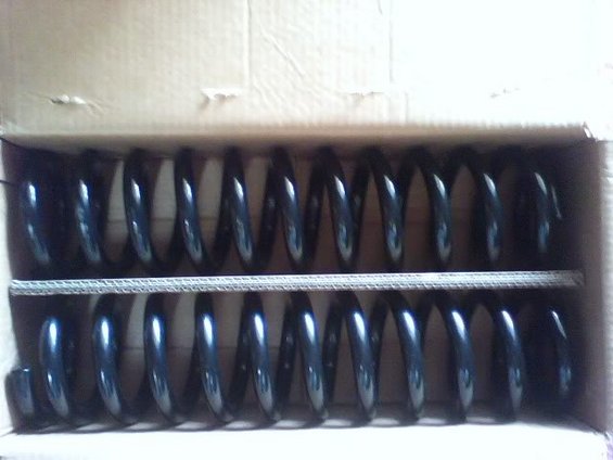

I'm going with the JBG Superlift 6-6.5 coil springs.

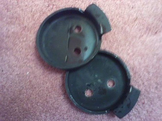

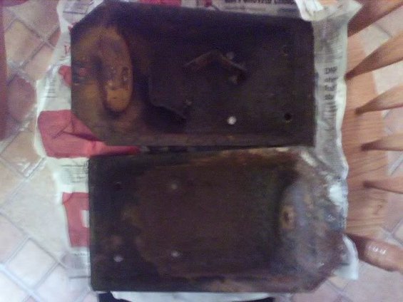

I have some 78-79 style coil buckets that I need to clean up and they came with the original upper retainers as well.

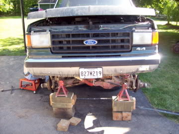

A pic from the front.
After some wrenching. :thumbup
Driver side coil bucket off, need to get the passenger side off today.
And a final pic of the bronco and my workspace...a corner of the driveway....:banghead

One suggestion. When you are doing the steering, test fit the tie rod clearance with the GLOffroad cover on since it's a lot thicker and could cause clearance issues when you try to turn. Other than that it looks like you are all set.

Actually the Ruffstuff cover is the front cover but I really need to check clearance. Thanks for the reminder. I forgot about that. :thumbup And I'm running the 30 spline outers for now, but eventually I will upgrade to the 35 spline. I just wanna get the swap done before I worry about more upgrades.

If you look at my SAS write up you'll see that I'm also using the Ruff Stuff diff cover, and my tie rod does hit it. In fact, I'm not even hitting my steering stops right now, the diff cover is limiting my steering. My steering is still better than it was with the TTB because my tires no longer rub the radius arms, but when I have time I'm going to clearance my diff cover to clear the tie rod.

Yea, I remember seeing your problem with the cover. Nice write up by the way. :thumbup should help me with my radius arm set up. Hopefully mine isn't a problem but I may have to clearance mine as well. Guess I'll figure it out when I get to that point.

And I also cleaned up and painted the coil buckets since they were pretty rusty.
