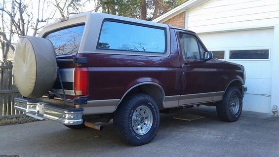

alright, so i have meant to start this for a while but have been busy. i bought this in late january in tucson, az. it was nearly exactly what i wanted, which was a nearly stock 1996 with gray interior, 351, and manual windows & 4x4. and, most importantly, it was in my very modest budget. so i flew out and drove it the 930 miles back to dallas. it ran great. i averaged 15-17 mpg doing up to 75 mph, as speed limits allowed.
the stats:
1996 Eddie Bauer
351w / E4OD transmission
Tow package
Electric windows & 4x4
"red" & tan
223,000 miles
relatively new & good shape BFG a/t
newer warn hubs
k&n intake
newer radiator
good brakes
good:
rust free
straight body
stock condition
door windows work
doesn't seem to burn oil
doesn't seem to leak any brake or transmission fluids
if it was a house, they'd say it has good bones
bad:
leaky rear-main seal
no a/c
back window/tailgate sensor problem
leaky back window
incredibly soft steering
engine won't warm up properly
no heater
only one speaker worked
airbag light is on
worn out interior
front bumper is damaged, needs to be replaced

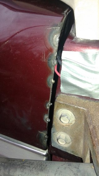

*back window leaked. discovered the tailgate skin was sheered on the passenger side. when the spare tire was not attached to the tailgate, the window sealed. when i closed the tire swing, the weight pulled on the skin and it pulled the seal away from the window. i got the skin welded (no, i can't weld) for $20 and now it seals. we'll see how long that lasts
this was my first attempt to fix the leaky rear window
here it is welded back together. i need to do some clean up, but for now at least the window shouldn't leak. and that was job 1. you can also see the leads for the rear window motor coming out of the back, too.

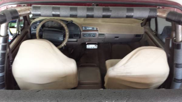

Looks like you've got yourself a project there. I agree on the roll cage foam. I would recommend some sort of padding for the top cross bar, but the rest can probably go. Unless you have kids, then hang onto it for now.
As far as the tailgate window safety switch goes, its probably not the switch at all. I'm willing to bet its actually the latch bolt bushings are either worn down and completely missing. Those bushings need to be intact in order for the latch to close properly. A few bucks at the nearest parts store should fix that.

Oh, and when you go get that tailgate re-welded, make sure the guy does a good job and removes paint from around the welding area so you don't end up with contaminants in the weld itself. That will just cause problems later on down the road.
thanks for responding, but i think you missed a couple things. i hope i don't sound too much like an arse.
when i first got it, the temp would barely come up. it was 30* outside and when i drove down the freeway, it would drop. if i was going up an incline, it would rise, slightly. the heater didn't blow hot at all. a few days after i got it home, i pulled the thermostat and it was installed backwards. i put in a new one. the heater works now, relative to the engine temp. but it still doesn't get fully warmed up. i'm pretty confident the new thermostat isn't doing the job, b/c i'm facing the same symptoms.
the tailgate is already welded now. i need to sand and paint the welded spots.

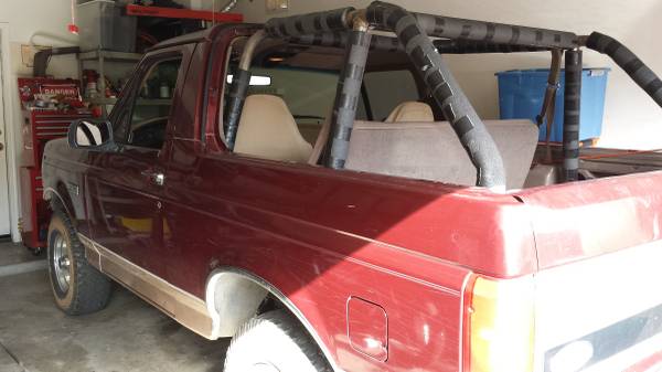

I pulled the foam pads off the roll cage.

first i set out to clean up some rust.
http://www.fullsizebronco.com/forum...e-free-zone/399122-cleaning-up-some-rust.html
