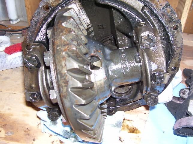

This is out of a spare 9" I have. I've never taken a 9" apart before and I'm used to being able to see more of the spider gears in different diffs.
Open, limited slip?
Thanks

Look where the ring bolts are. If I can remember correctly the LSD is countersunk a bit where the bolt heads are. Yours isn't so I would say Open also.
