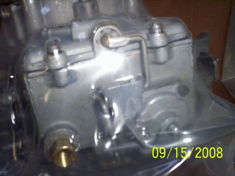

I bought a remanufactured 2150 Motorcraft for my 79 Bronco, 400, c6. Its a little bit different than the 2150 I have on there now. I was wondering if it will still work the same? I still have new rebuilt carb in packaging.
New rebuilt one.

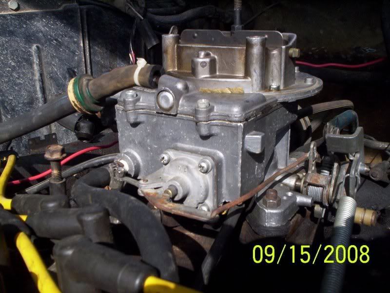

Old one. The hose I have running to the top of the carb can I take it off and block off the port at the carb?
