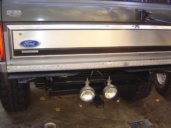

Does your 80-86 Bronco have a strange rattle coming from the tailgate area that you cant seem to track down. Is it a high pitched tinny sound, that only happens at certain RPM's, or under certain acceleration/deceleration?
Unable to track it down?
Been driving you nuts?
Perhaps it's your rear valance/rear apron/bumper gap filler/finishing panel/thingy mabob....
Ok, so I don't actually know what it's called, but on an 80-86 with a smoothie bumper it goes between the bumper and the body and fills in the gap between the two.
Looks like this.
And if it's bone stock factory it will rattle to high heaven, but only sometimes.
The fix is super easy, paint the backside of it with about a can of ruberised undercoating and put peal and seal on it where it contacts the frame and bumper brackets. I also put some in the center to add a bit more mass to that area.
Then just slide it back into place and no one will ever know anything was done. :thumbup
A little close up view for you 87-96"rs that have no idea what I am talking about.

I often wondered if that was the culprit, the sound is awful in my Bronco because I don't have the vinyl flooring or insulation anymore.

interesting its metal, on the 87+ its plastic and mine is long gone

my 84, 85 and 86 had the plastic gab filler peice. But they where all step bumpers.

lol I thought this thread was going to be about the exhaust shield rattling.
My valance doesn't rattle but the original one did.:toothless
