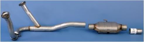

OK, I have an '85 351w that had the downtubes-cat replaced with an Eastern single cat downtube setup. Now I have to replace with original dual cats (to appease the CA smog Nazi's) So no worries? Magnaflow 33007 front, 34016 rear. Trouble is the downtubes need to be the two separate 2" type and the Eastern setup is into a single "Y" 2.5" at the wrong angle-position.
Have this
Need this
LMC has the original downtubes with cat that is of course NOT legal in CA under the 1-1-09 rules (just like everything else). I've spent hours searching for something at least near stock to make this work. Been to the wrecking yards, but in CA they cut out the cats-downtubes as soon as they pull them in cause they can't resell used cats and I assume the sell them for the metals.
Short of having a new exhaust system custom fabbed (which makes my wallet light just thinking about) does anyone have a source for original configuration separate downtubes that will work with these two in, one out cats like Magnaflow 33007 that are the only ones available in CA? :banghead
