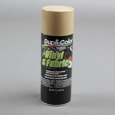

I thought I'd start another thread on my interior build since I'm using another cool product. From my Monstaliner thread THATSaBIGone503 gave me a great tip on faded interior paneling. Duplicolor vinyl and fabric is simply "da chit". The best easiest spray paint I have ever used. No runs at all, can paint just about over everything. The bronco door panel has a metal strip, abs plastic everywhere, carpet, some type of hair type thing where the door handle is, screen, the same spongy dash material on the arm rest, and some type of quilt type stuff between screen and abs plastic. I simply sprayed all those surfaces on two passes and the finish is absolutely flawless! it will be a week or so before i get a finished pic on the whole bronco, but couldn't wait to post these up.

I wonder if it comes in the fard camel/sand/tan/whatever color the tan interior is called. I could really use this stuff!
They have Black-
So its either grey or black?? Bummer, stuff looks like it lays on nice.

By the way if you have the tan interior, the desert sand is too yellow in my opinion, try the medium beige, im about to shoot my first piece in a few minutes, i'll post up once i get'er done...any updates BurlyQ???
