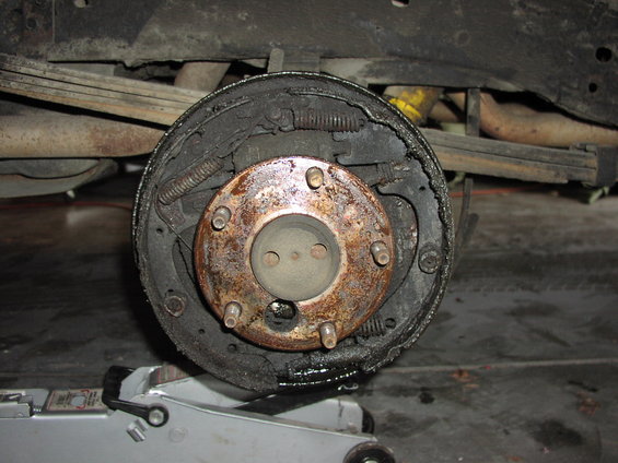

Step 4: Pull off the drums...
if they look like this be ready for some serious cleaning!

Just a stupid question but are those two primary shoes on that wheel or is it just the picture?
The 9" I just re-did the rear brakes on last week used four identical shoes -- both the set that came off (what was left of them, which didn't include much in the way of pad) and the new identical set of 4 that went back on. I was under the impression this was normal, and the system works fine ...
ditto...same size on it and replaced with the same size. It seems like back in the day when I had my '78 F-100 it had the different size shoes for the 9" I guess it is cheaper for them to produce the same size and it doesn't effect the braking? :shrug
Mine were different
