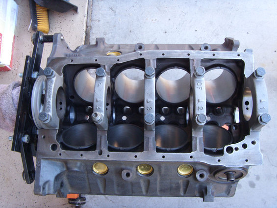

When I pulled the motor out of my truck last week I had no intention of rebuilding. It was pissing water out of two freeze plugs, leaking oil, and barely hanging on with a bad motor mount. Curiosity got the better of me and I ended up tearing it all the way down, so it turned into a "might as well" project. Here's how I got the block back today:
Goodies:
New specs:
351W
Rebuilt stock E7 heads
Bored .030"
Sealed Power hypereutectic pistons
Perfect Circle cast rings
Crane PowerMax RV-ish cam
Melling oil pump
Clevite cam/main/rod bearings
Victor Reinz gaskets
Cloyes double-roller timing set
Just wanted to share my crap. :thumbup

Sorry to rain on your parades, dudes, but I only have about 2200 miles on my Ranchero's 351W (retrofit) and it looks like it has five times that mileage. I do plan to have it steam-cleaned, but until then, it looks like Hell. Doesn't take much to turn Beauty into the Beast. That block looks like it was fired and shot-peened (that's what was done on mine); was it torque-plate honed?

Youre not raining on my parade at all. Sounds like you (or whoever built it) didnt do a great job putting it together, at 2200 miles it shouldnt have leaky gaskets. My block was hot-tanked and bored .030". Assembly begins tomorrow after I pick up the heads and some assorted bolts. Still havent decided what color to paint it, probably grey on the block and maybe black on the plenum and v/c's.

Well, yes and no. Driving will get stuff dirty, but the oil is what makes it look like ass. If your car has sat that long, thats why its leaking. NOT driving a car is almost the worst thing you can do to it.

:brownbag I know, but I also know I would knock it over if I stood it upright. Its only been sitting there a few days and will be back in tomorrow.

I see a crank in the background but didn't know if you were going aftermarket or machining the stock crank... Hense I do not see how it is going to work without a crank applied to said motor everything else is mentioned short of the intake set up (you are probably going stock on that I am assuming and the same for the exhaust). Also, I am giving you a little shit.

That makes more sense. :thumbup The stock crank is in great shape and is going back in, as is the intake, and already had a pair of Hedman long-tubes. It was just a little vague, so I figured it was stupidity.

is that cam SD compatible?
Satyr of the Midwest
17,747 Posts
Yes. It's in Crane's CompuCam series, LSA is 114º, duration @ 0.050-in is 206º/214º, lift is in the mid-0.400 range. Should work well and keep a lot of low-end torque.
