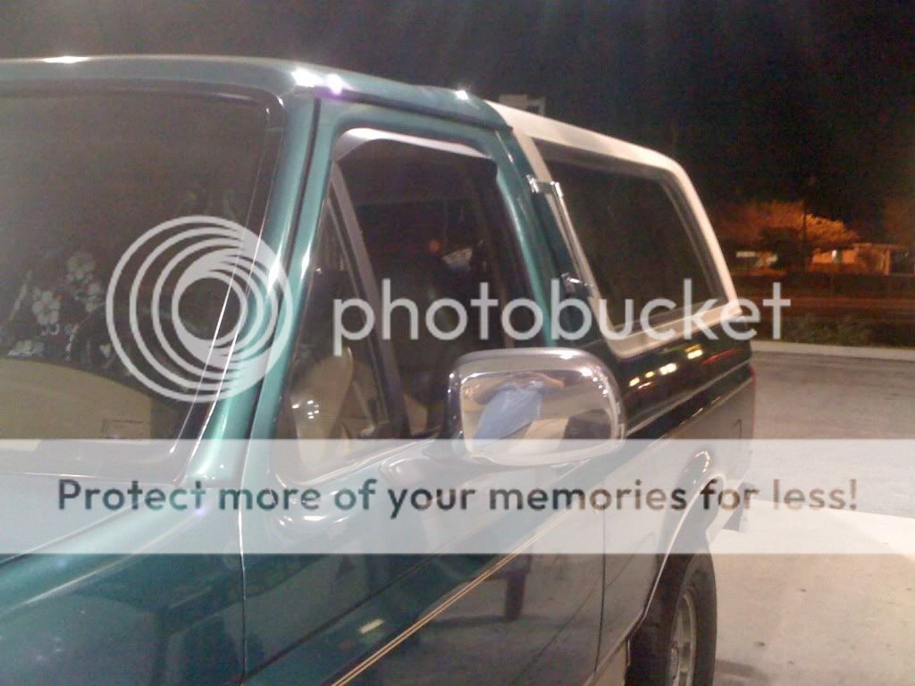

and while i was flushing the cooling system I put on the side window visors.

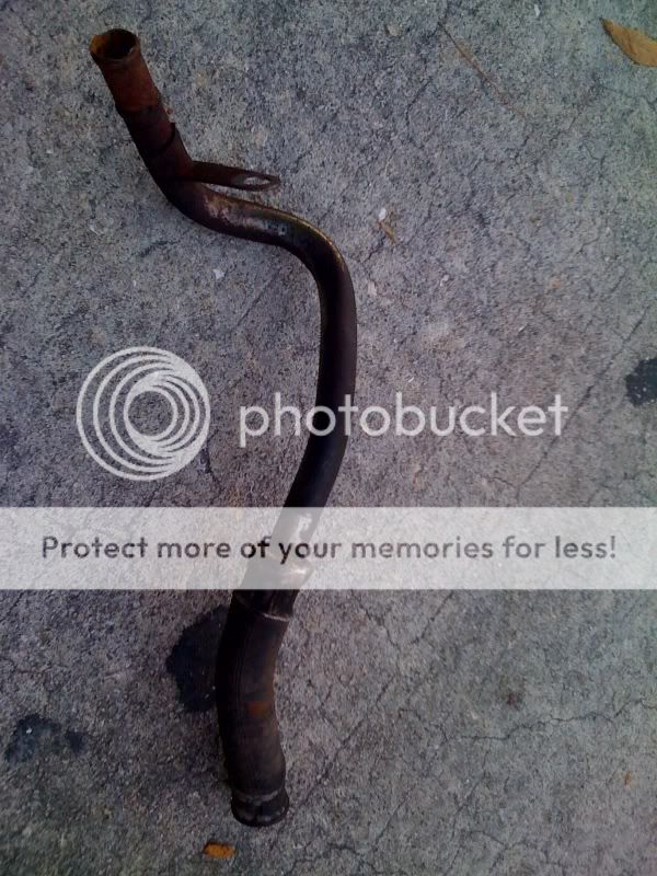

Scored a newer steel heater hose tube from hte water pump to the heater core today at a Junk yard, was from a van that had a 351. tube was almost like new. the newer one is to teh bottom and the old one is to the top. Paid $5
Scored a stock rim to use on my spare tire also while i was at the Junk yard. Paid $50
Finished up hooking up the bottom radiator hose, the JY tube and makin sure all the bolts were snug on the waterpump. Need to go back to the JY tommorrow and get a metal heater tube that goes from the core to the top of the lower intake manifold where the ecm temp sensor screws into. Found that tube had started to rot from the inside like the other tube was.

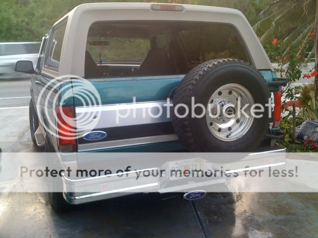

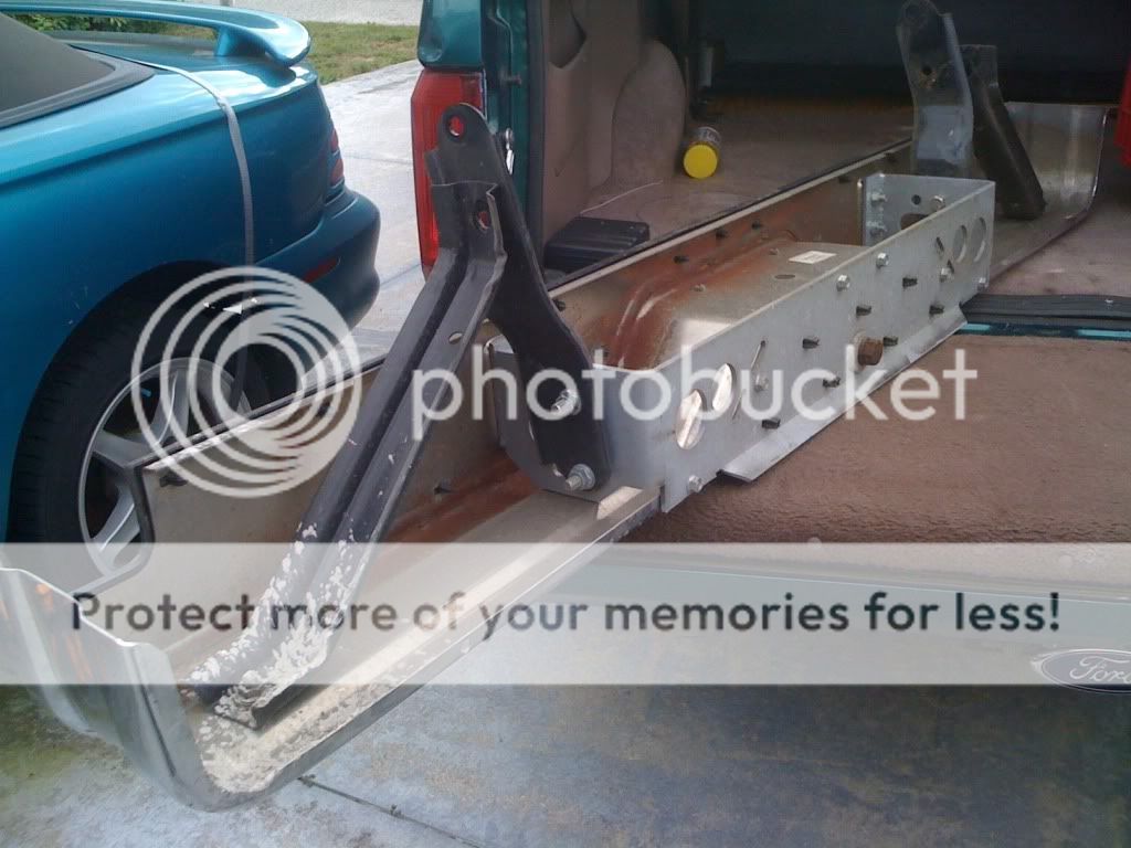

Found a Nice Bumper today at a local Junkyard. It came off of a F150.
Here are picks of it.
Before
New bumper before install
Installed and all done, I also fliped the tire carrier upside down to lower the tire a little.

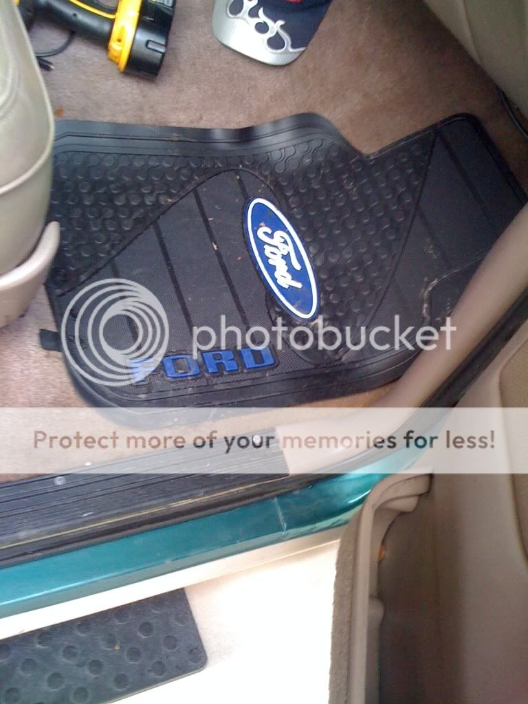

I got tired of them slowly moving around so i went to a Junkyard and got 2 floor mat anchors from some exlpores and put them into my bronco on both sides. Looks stock and my mats should slide around at all now :rockon

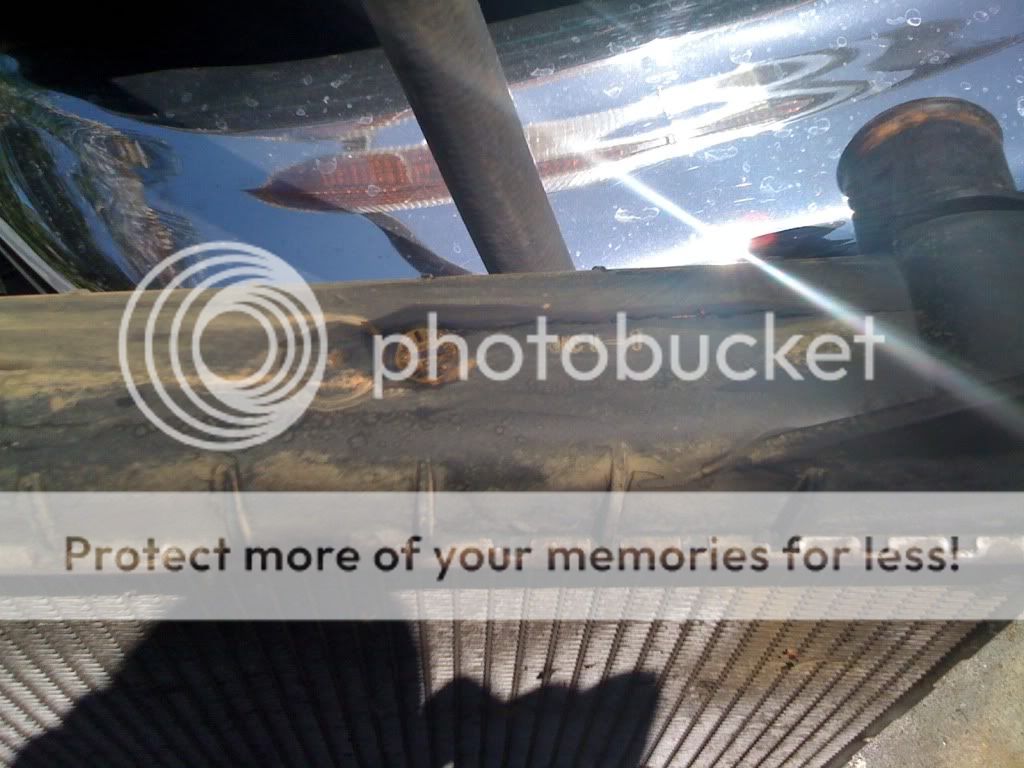

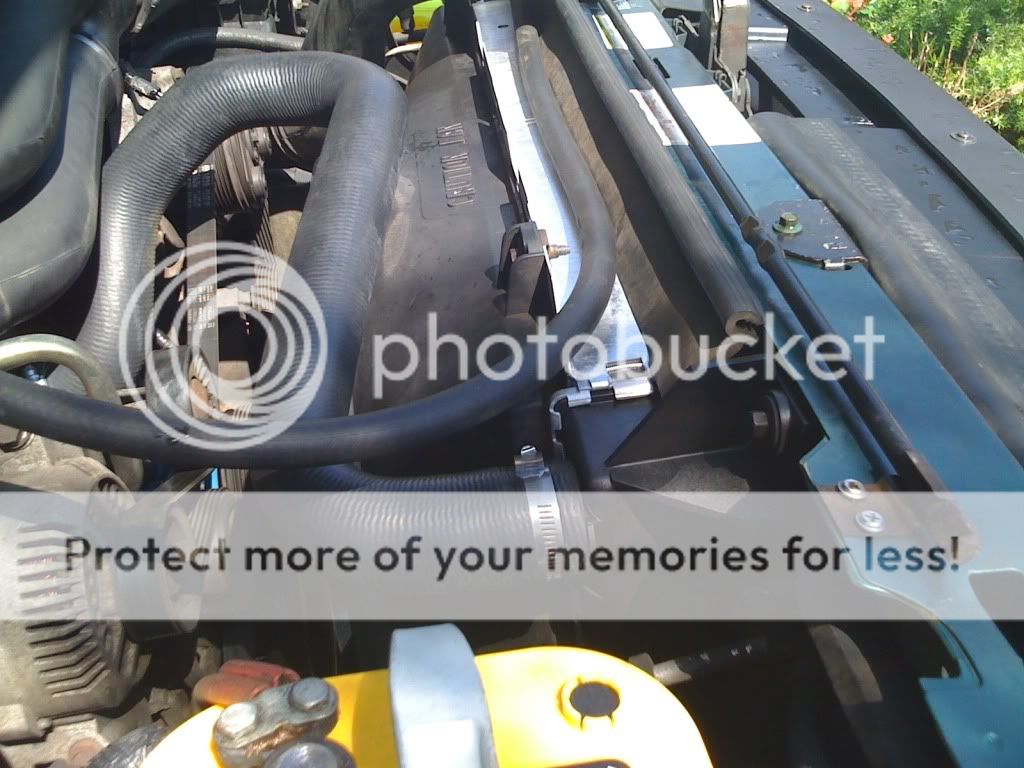

Had to install a new rad today. what I thoght was a small leak from the rad drain plug turned out to be a hair line crack higher up on the side above the dran. Found it yesterday when my truck started to get hot and steam started coming out of it.
Before
After
Got the rad from the dealer where I get all my parts from....ran me about $777.
Didnt want to get a cheapo from the local parts stores and needed it asap so couldnt wait to order it online....seeing this is my DD.

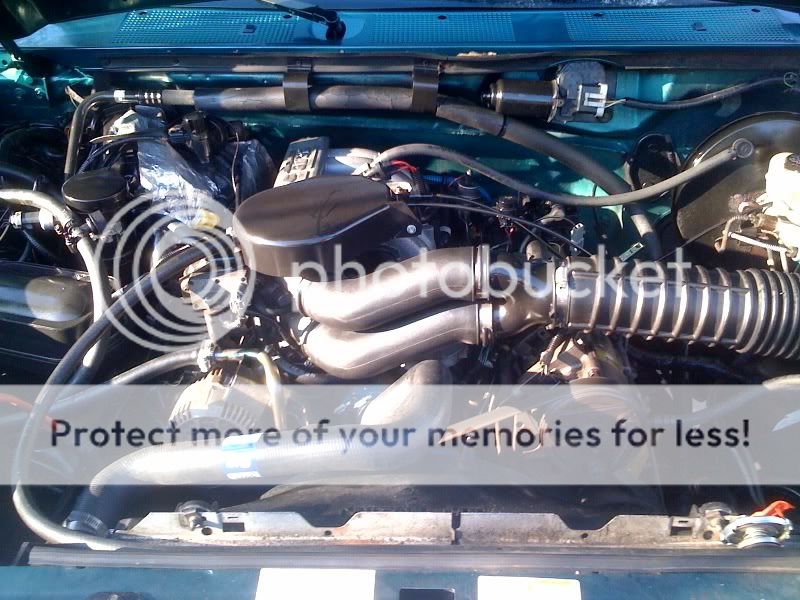

My engie light came on monday morning on my way to work. Everything seamed like it was all working fine no hesitation or stumbling or rought idle. Had the guys at Discount auto parts pull the codes for me with there reader and we got a P0171 - System lean. Wound a leaking Brake booster make this code come up? I know mine is leaking cause I can hear a leak when I step on hte Brake pedal now as well.
