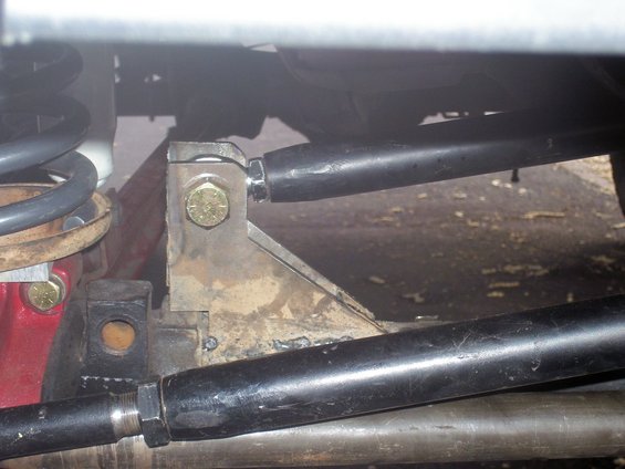

Well my SAS thread kinda died off So I thought I would post up the finsished product.
SO here it is Remember Before
The axel almost in
Just after rolling out
Heres the Axel Links and stuff
Remember heheh
TADAA!!
Lower mount Pirated from scott
Upper mount I used the stock from the 79 and Cut welded and braced.
Radius arm brackets Angled 22*
Lastley my Neat sticker
There we go its done I had a few problems at first but got those worked out thanks to scott and clint. it still needs a little alignment but other than that we are ready to play. I got a kitchen pass for tomarrow so I hope to have some flex pictures.

not bad, glad to see you finished. you gonna paint those brackets, right! It'll look alot better and hide some of those welds. But at least you're done for the most part. :rockon

yeah I ran outta black paint today didnt want to use red.

oh and its kinda of hard to tell from the pictures but your welds look a bit sketch. the track bar one barely looks to be sticking those two peices of metal together. to fast and cold. might concider having someone go back over them and weld them correctly

agreed. buzzing the stack of dimes along that piece is crucial to the whole structural support of the rest of the suspension and steering, since you have more forces acting upon the top mount.
