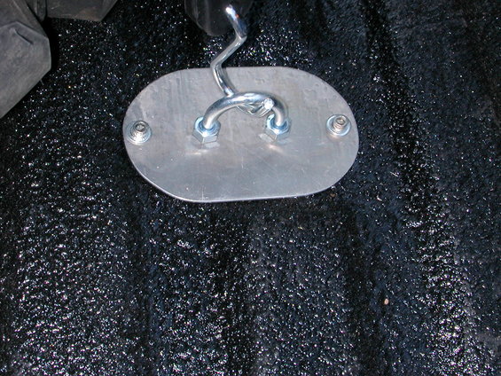

8. side trip! mark TWO of the smaller plates you have just made for the U-bolts you bought and drill them out. install the u-bolt by first maxing a nut out on each side of the u-bolt, to act as stoppers. then install u-bolt with backing plate and nuts.
9. remember that weatherstripping you bought? Open it. Apply it all the way around the bottom side of the covers, making sure to keep it 1/8" away from the edge of the cover.
10. align the plates and start the screws. the u-bolt style cover should be in the rearmost position. my #8 screws were hex head style, because im all about the bling bling. tighten down evenly, and you are done! :rockon
All tied down. tested as of this past weekend and they hold up good!
