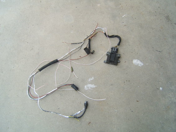

Remote Mount Black CCD "Computer Controlled Dwell" ICM
Ford Bronco -
[/IMG]
Motorcraft - DY1077 (supercedes DY679, DY667, DY645)
Ford - 5U2Z-12A297-D (supercedes F1PZ-12A297-A)
Wells - F139
Niehoff - FF413
BWD - CBE40
Standard - LX-241
NapaEchlin - TP29
Delphi - DS10056
Transpo - FM544

Didn't you relocate your IDM/TFI to the Fender Sig?
If so,what was all involved? Did you have to get a new dizzy? One with the harness coming off of it? Or, did you open up your existing harness and re route wires?
I think this push start IDM I have is my MAIN culprit as to why my rig is running weird. So, I am in the process of relocating my IDM/TFI to the remote kind.
No, my Bronco had a remote module from the factory. I did, however, have to rewire a bit when I converted to a mass-air PCM. The 'start' signal line is capped off, and the IDM line now goes directly from the ignition module to the PCM -- none of that IDM resistor nonsense running all the way back from the ignition coil.
Gotcha.
I think I found some more information on how to do this relocate.
http://www.therangerstation.com/tech_library/remote_tfi.htm
I am hoping I can do the same as this write up has done.

I think I will be changing to a remote mount as well. This will require changing to a Black "CCD" 6+3 Pin TFI Module and modifying the wiring by changing the "Start Signal In" on pin #3 of the TFI Module to "IDM Out", bypassing the 22K ohm resistor, which is sent directly to Pin #4 of the EEC computer. Note that you will still use the wiring for the Distributor Mount TFI below.
But when using a Black "CCD" 6 Pin TFI Module, the wiring change is much more extensive. Note the 8 Pin Connector.

I am hittin the JY this weekend, Seattle. Do you want me to get an extra heat shrink if you can't find one? I am gonna get a couple of IDM's as well. I can't afford new at the moment so I am hoping to get lucky.
Let me know.
It's the way we have to go I believe.
Let me know.
That would be great! Also, look for the section of harness to the TFI. Inside is specific EMI aluminum shielding for the PIP, SPOUT & IGN GRD wires that will be useful if you have to extend your existing harness.
