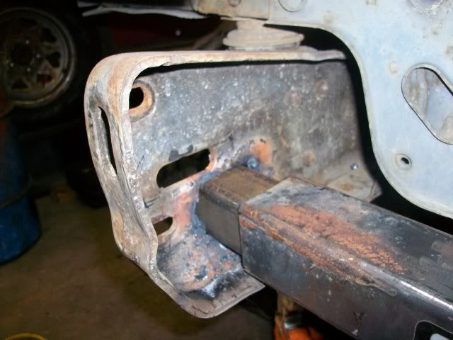

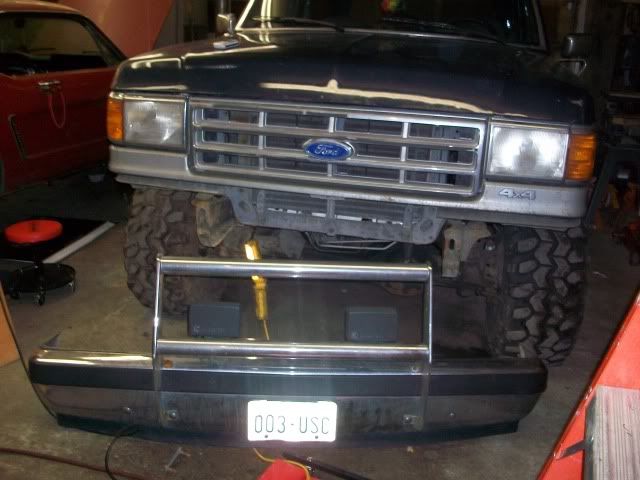

-Well first i took the bumper off..

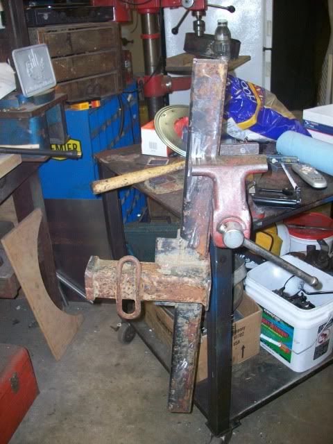

-I started with just a regular hitch receiver we had laying around
-Than i cut the ends off of it.
-Than i cut (with a torch) a "square" in my frame (both sides obviously)
- I took some receiver tubing and ran it through the frame and through the hitch receiver
Since my wholes werent perfect, i got it even and about where i wanted and tached it
Once i got it where i wanted, i welded everything completely up
than i cut a whole in the bumper and put it back on
I still need to paint it :doh0715:
and when i do that i am going to weld some 90 degree trusses on it
but i believe itll be pretty stout. Its held up so far to everything ive thrown at it.

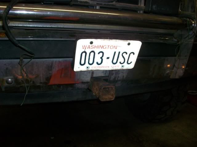

My license plate looked stupid too and this is the only picture I have of the new bracket i made for it
out of some angle iron

Hey Vance,
The front hitch looks great and as long as it's solid and holds up who cares right? Why don't you do for your front plate what I did for my rear plate. I have a Smittybilt tube rear so I just took a slip in receiver piece that still has the hole inside for the lock pin, cut off the ball end leaving just enough sticking out to tack weld a piece of angle iron on top. Then drill 2 holes in the angle iron, the width of the top license plate holes, and bolt on the plate. You can take it off when you need to tow and pop it in and lock it when you don't.....plus your locks always there when you need it. :thumbup -Kevin-

Nice idea! I might just have to hit up the yard with a tape measure to find a hitch just the right length to be able to bolt it in after welding new brackets.
