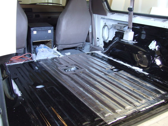

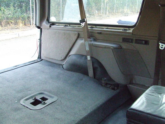

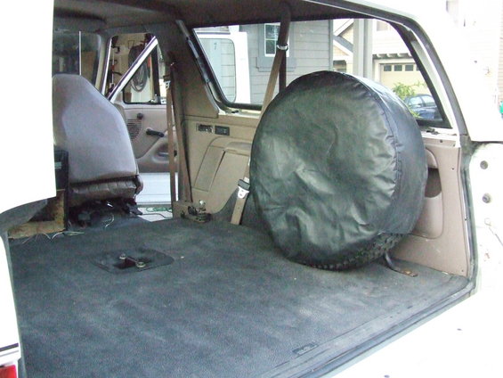

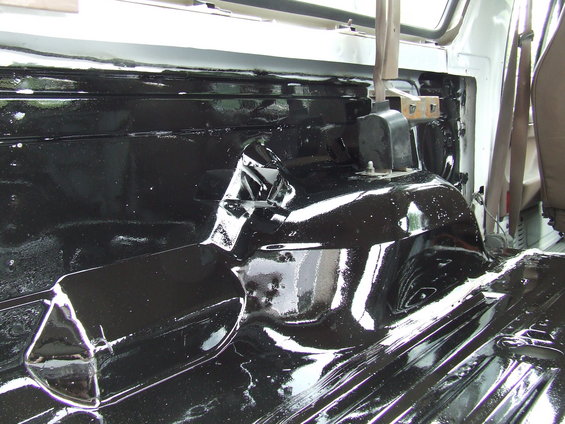

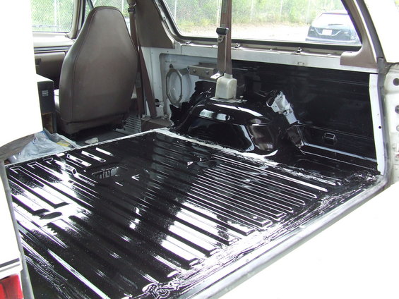

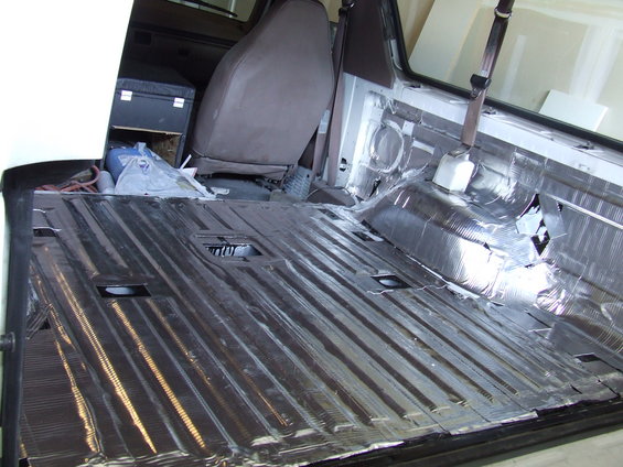

POR-15 and peel and seal cargo area
found some XLT rear panels from a jk

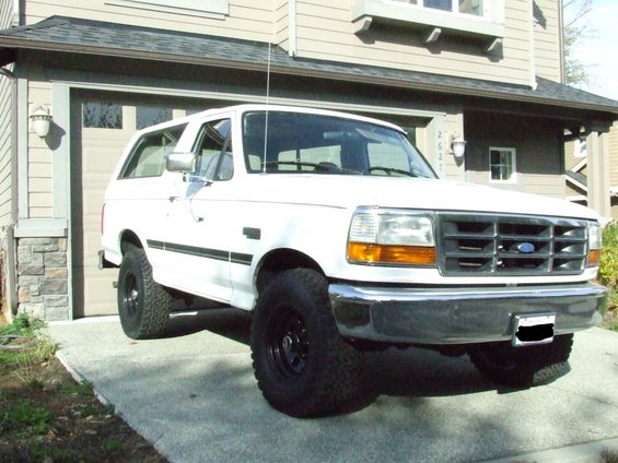

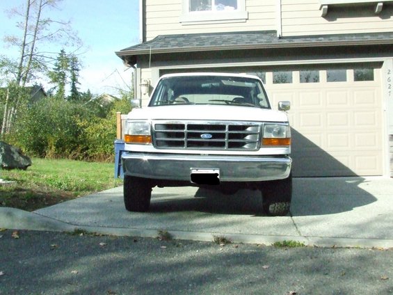

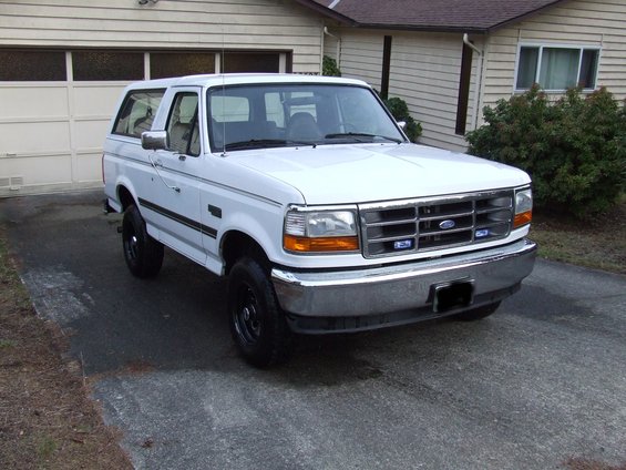

new 32x11.50x15 BFG A/T's with black steelies

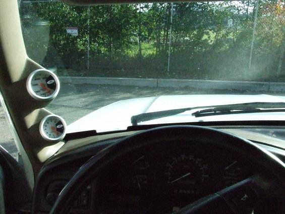

gauge pod holder with trans temp and tach

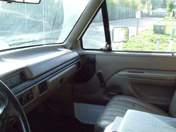

new 6.5in component Kenwood's, plus some 6x8 kenwood's for the rear

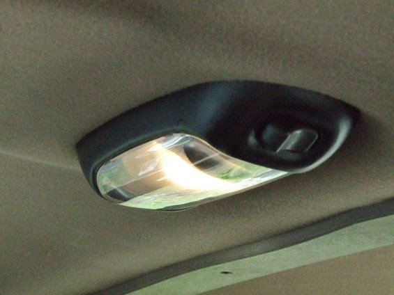

new dome light

Old Setup :(
New and improved!

Looks great man. Will be subscribing to this one. Once I fix my leaks I might think about putting carpet back in with peel-n-seal

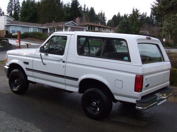

What color was the truck originally? I have never seen black door trim like that on a white truck
98 Posts
door panels where the speakers are I painted a semi flat black to hide the tweeters a little better, thought it would look kinda cool. the rest is stock, standard beige with black XL trim elsewhere. glad i did a good enough job that you didnt notice that i painted it. ;) lol

The rest of the tie rods come in today. those are radius arm, front sway, and axle pivot bushings. springs are moog cc820, thought i would give those a shot and see how they ride, hoping for a little front in lift since it currently sags a bit. and of course the stock height bilsteins. sorry guys, i dont plan on doing a lift. :whiteflag

Looks good. I like the white truck/black wheels combo. :thumbup
What kind of gauge pod is that? Is it a whole piece that replaces that trim piece? Looking to get one for my CC 350. Also, did you paint it or was it pre painted?
I'm 99% sure I bought those same springs. Raises the height a bit and is about level with the rear. Makes the 33s look like they came on it stock. I used KYB 2" lift shocks and it was a perfect fit. Rides and handles pretty nice now.
Oh and the only bad thing about those springs so far is that the paint is already peeling off, and I got these like the end of of August.

Gauge Pod is from Summit, they have a two and three version. it actually goes over your current trim and has those push tabs, like those used for door panels and whatnot. I didnt use them though and just screwed it into the existing trim holes, didnt want any noises. ;)
i am hoping i dont need different shocks for the front if it raises it up a bit, i mean its supposed to be a stock replacement but heavy duty. and ya, the paint is chipped a tiny bit already, but im not getting them to admire their beauty. ;) how do they take corners and whatnot, do they have alot of give or are they stiffer than stock? right now, between my stock springs and my POS procomp E3000 it feels like I am on a trampoline sometimes ;)

nice truck! did you do any prep to the rear cargo area before you por-15'd it?
98 Posts
Discussion Starter #15
ya, stripped it down to metal, made sure the surface rust was gone, then por-15'ed the whole thing.
What method did you use to strip?
98 Posts
Discussion Starter #19
just a 4.5in grinder with a stripping wheel from harbor freight, i dont remember the type off hand, but i read someone else using it on this forum to good affect, so i thought to give it a try. worked pretty good, went through two of them. the only hard part was stripping the paint off in the ribs on the bed, other than that, took about 2 hours to strip and about 2 hours to apply a couple coats of POR-15. the peel and seal took a little longer, took my time and spent a saturday doing it. works great, really quiets the truck down alot.
254 Posts
Thanks :thumbup great work so far
