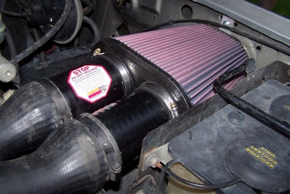

got my K&N filter in today. cost me $50 for everything. it sounds freaking cool. i don't care if i gained any power; it sounds and looks much cooler.
heres my write-up so every one will stop asking how you do it.
Remove the old air box and all the other junk.
Since this is ghetto fab time, i needed to find out the length of the tubes i would be making.
the freaking PVC i used only came in 10 foot lengths. so i made a new exhaust pipe.
I cut the PVC pipe to 6". not precisely 6", but its in the vicinity of 6".
i thought this would be the easy way to install it.
It was much easier to put the pipe on the intake tubes and then jam the filter on.
Done.

peepee: the filter has a port right below where the 2 big pvc pipes go in. its the same 5/8" size as the breather hose. i just got a new breather hose and a 5/8" double male adapter and plugged it in there. if you look in the last picture, the breahter hose snakes over the intake tubes because i am too ghetto to shorten it :brownbag
also, the real kit comes with a bracket to hole the filter to the fender. heres what i did: the filter has a little stud on the end that the bracket is supposed to attach to. i just poked it into a hole in the sheetmetal.

ok, like most of my write-ups i didn't do a good enough job the first time....the filter kept popping off the PVC pipe and leaving me without filtered air.
its not hard to do, you just need to get creative:
the PVC bolts to the bracket and the bracket bolts to the inner fender. you can see where the breather line is routed as well.
i think it looks a million times better and its way more solid than before; the filter was pretty much just laying there. K&N does their kit this way as well, so now its an even closer copy of the K&N kit.
the stud at the end of the filter is for the K&N kit, which includes an L-bracket like this.
done, until i find a way to make it better.

Just finished my K&N install on my new (to me) 95 Bronco. Thanks to Andy for the base measurements and part number. Took some of the legwork out of it. I used two 6" long sections of 3" exhaust tubing expanded out to 3 1/8th inch. I also ended up leaving the bottom of the stock box in place. This allowed me to leave the duct work that picks up air at the leading edge of the hood in place. I put door edge trim on the sharp edges of the lower box where the filter rest on it and then drilled a hole with a rubber grommet on the inner fender. The stud on the filter element then slid into the grommet. Have to wait and see how well it stays on. It has some pressure pushing it against the inner fender as it sits now. If it moves around too much, I'll weld a strap to the tubing and attach to mounts of the lower box.

and yes, yet another update: the PVC pipe i had used for some reason had begun to taper in where the hose clamps were so it wouldn't stay in the filter anymore. now i'm running 3" exhaust pipe in there and it seems to be much more solid than the PVC ever was.
