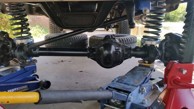

More Pics......but I need to see your track bar length and type and how you fixed it to the axle. Did you use the exsisting track bar mount on the axle? need a pic.....PLEASE.....:twak
Did you not look at my pictures? What you are asking for is already there. :goodfinge
Its not fully adjusted yet. I still have to do that, but it is close enough.

BTW how does the track bar and pumpkin clear the crossmember? On the 4 links I have done I used a Offset shaped bar. It looks tight in there is all, I did a Bronco II many years ago and had to cut the crossmember out to clear everything.

It all seems to clear perfectly. I'll need to flex it out when I get a chance to double check, but I don't think I'll even have to trim the crossmember.

Yeah so it looks like you used the factory stock bolt position and bolt at the axle, but a straight track bar. OK
