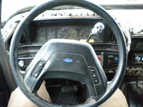

Decided to spend a little of my tax return on some bling and fix something ugly thats been staring me in the eye since i got the bronco. the stock late 80s steering wheels are ugly, flexy, and i don't like how awkward they are with the 2 legs only at the bottom.
Picked up a Grant #748, 4 spoke 14" 3" dish wheel and install kit #3249
ugly clunky stocker
