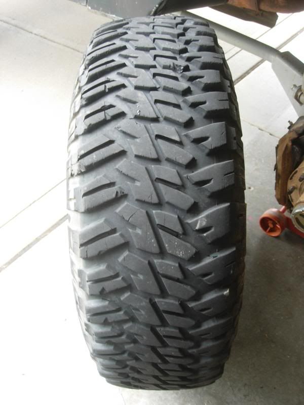

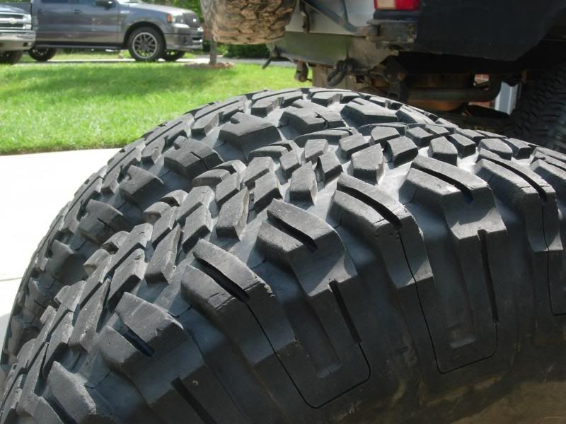

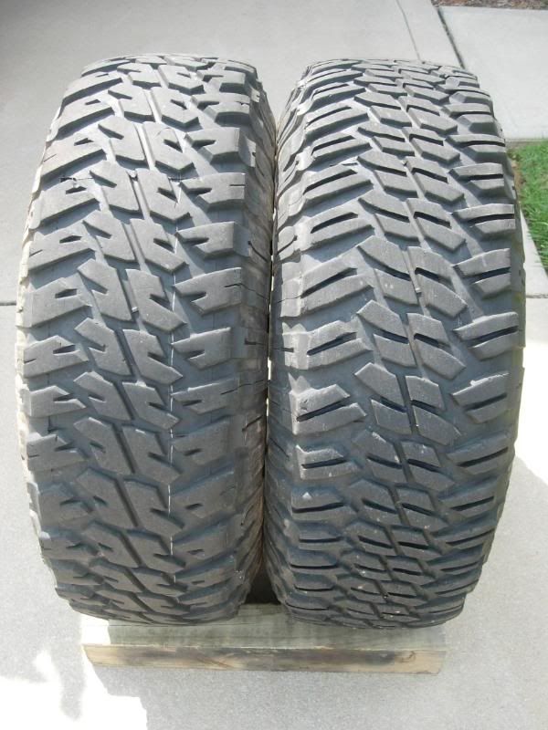

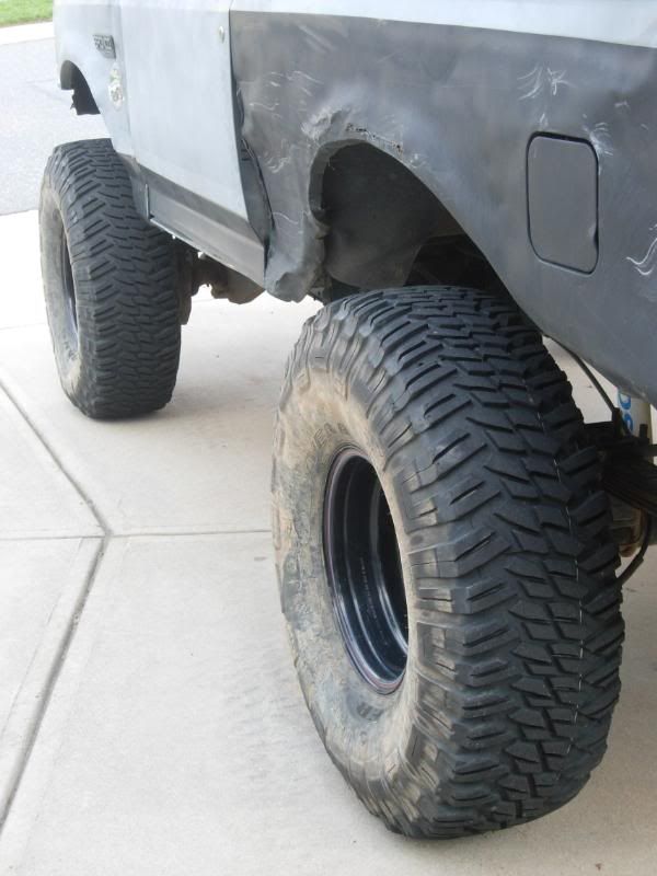

Decided to improve my MTRs a bit. Used an Ideal Groover with a #5 blade.
The comparo...
Mounted up...
Considered leaving this pattern, but then figured why only go half way...
I've loved how the MTRs have performed overall, but they're getting a bit lower in tread depth after 4 years of trail runs and some street time with a spool. I expect all those new biting edges should be noticeable on the trail. Hitting Uwharrie National Forest on Monday, so there will be a report when I get back.
