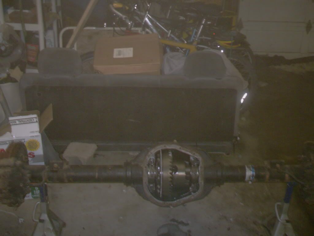

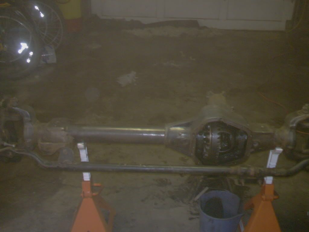

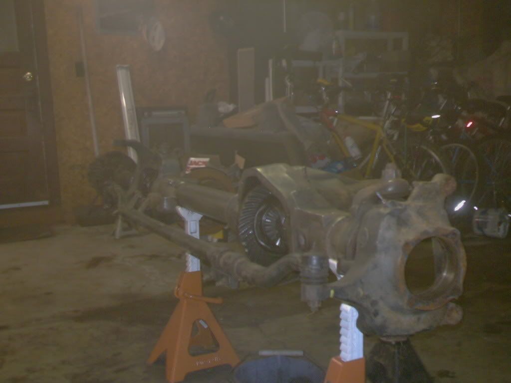

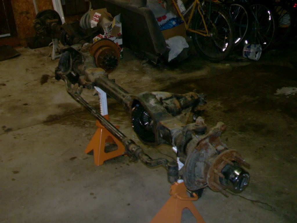

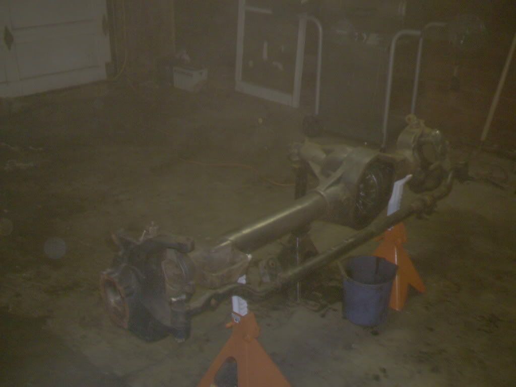

This thread will be my pre-sas thread, ill try to document all the prep work that i will do to the axles, gathering parts and such, my actual swap will be done this summer with any luck.
Ive been reading through the sas threads here for a while now, but i havent come across a single person that has documented a superduty sas . So I plan to writeup my swap:thumbup

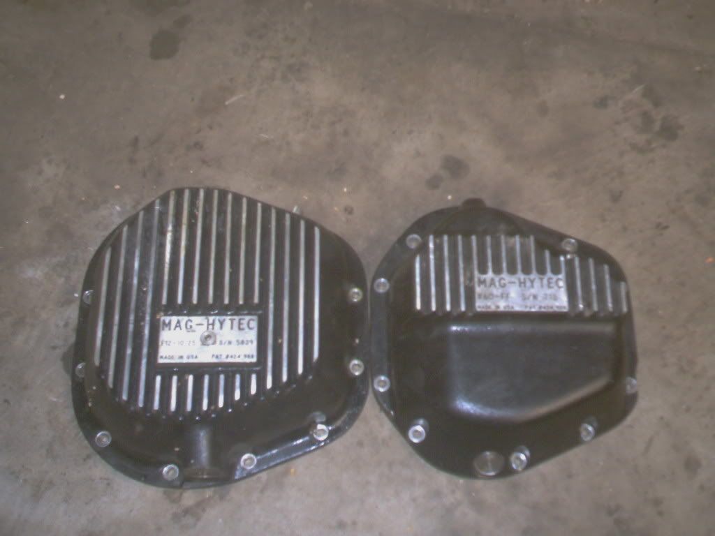

I will be using axles out of an 03 F350, 60 and 10.5, which i purchased for $1000. The already have 513 yukons, warn hubs, crossover steering knuckle, fancy aluminum diff covers:toothless, limited slip rear, new ball joints, and fairly new brakes.
With that said, i got started tonight preping the axles for a good couple coat of por-15 or similar. I drained the fluid in both the axles. I got started on the 60 first, plulled the brakes off, and most of the outer stuff, except the knuckles, used a drill and grinder with wire wheels to remove the paint and rust. And thats where I stopped tonight.
Also, I just wanted to add that this is being done on the budget of a college kid, so please be patient, and dont be afraid to give me some advice:thumbup

I think you have not seen documented superduty SAS builds since most people are told to avoid them. From your pics the 60 is the unitized bearing setup? Beyond that most would prefer to get their hands on a kingpin 60 over one with BJ's. lastly that would have the metric bolt pattern?

well from the pictures you can see that there is no drivers side tube. just knuckle and pumpkin. metric wheels, unit bearings, but it's still a 35/30 spline with a big ring gear.
i really want to see what you do with this axle. i think they can but easily used. just need someone for the masses to follow.

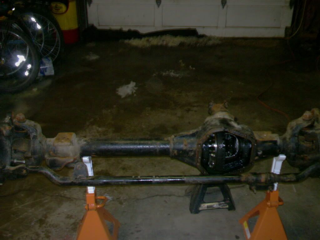

If you really want some new pics.... Like I said, my bronco is gone and IDK what im gonna do with these... But they sure do look perdy
Please note... rims do nothing for offroad ability... as for increasing my "baller" status, thats another story:rofl:
