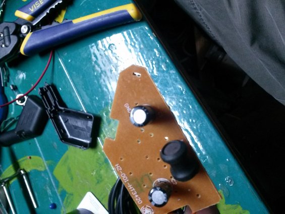

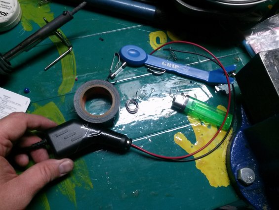

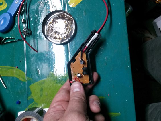

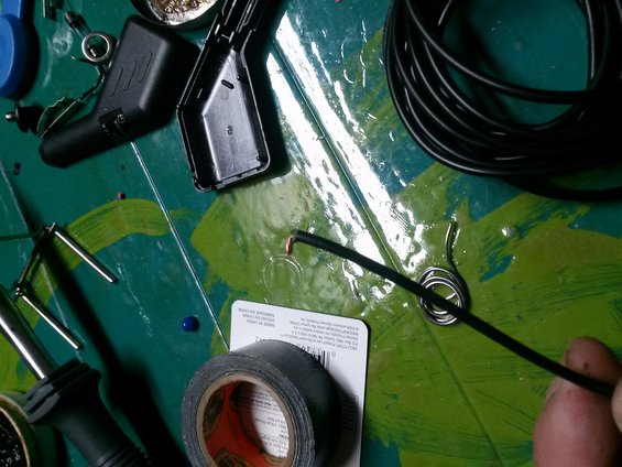

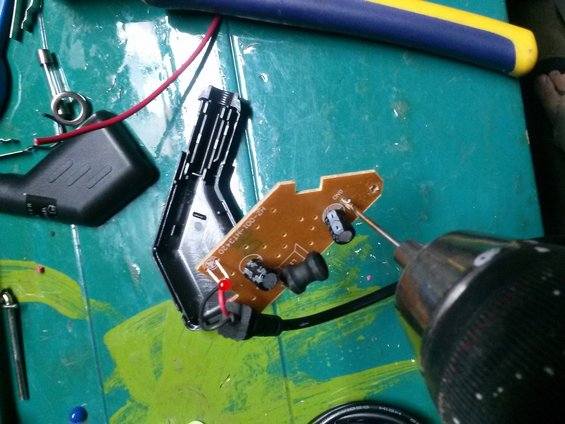

first you open your cigarette lighter charger
solder off the spring and the ground wire

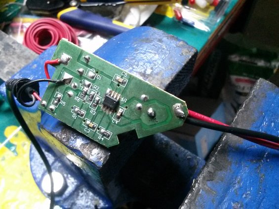

drill out the circuit board to accept the size wire you're using (i used 18 gauge)

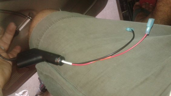

solder the wires in place. note: i'd recommend directing the wire to face the outlet of the charger cover. that will help reduce stress on your solder.
then put the charger back together
i put a 1" cut of heat shrink to help hold the wires together and further reduce stress on the solder.
tape it closed

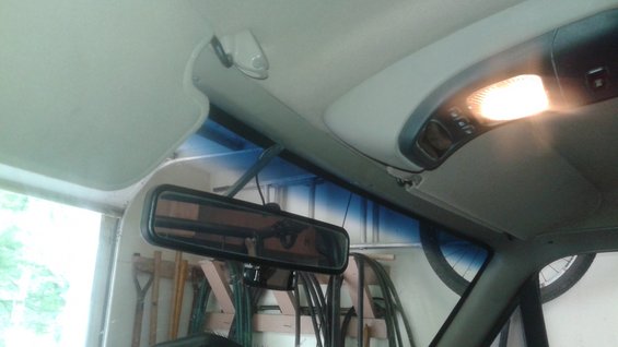

in my truck, i removed the headliner trim over the window, and the A pillar covers.
then i took out the head console.
i popped a couple clips and dropped the wiring down where i could touch it.

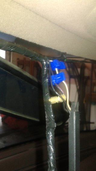

i took my continuity tester and determined which wires in my auto dimming mirror was hot and ground.
i used t-tap connectors to tap those.
i added the 2nd piece of the t-tap connectors to my charger

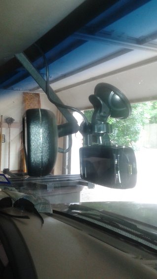

after that, i tucked the charger into the head console in the headliner, with just a little charge wire hanging down.
now, you're pretty much done. just put back everything and you're good to go!

for this application, they'll be fine. if/when i get around to installing a better mirror, i'll have to cut off the OEM harness and splice in a new one. at that point, i'll look at improving the connection. for now, it's sufficient.
