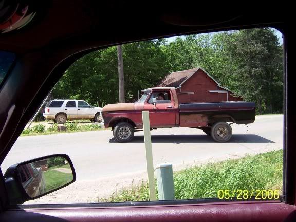

Well I only got one picture since my camera man sucks!

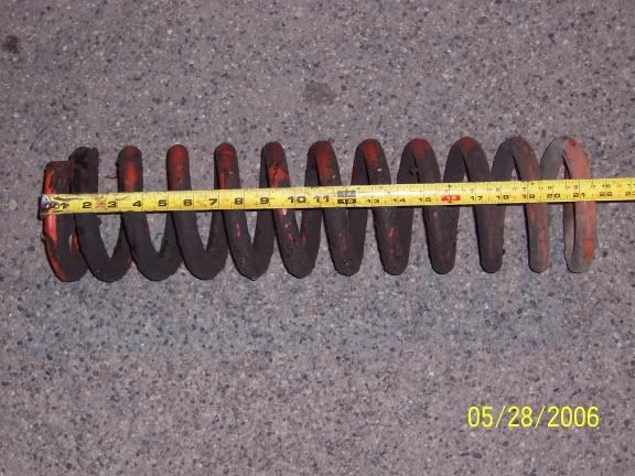

and here's a picture of the coils I want to use from the 78 bronco. Anyone know what lift they might be? Also will the radius arm brackets work from the 78 to swap into the 77 f-150?

yeah thats why I won't be making my own radius arms for awhile.. So they will bolt right in? I was told the 77 frame is different then the 78 bronco and it won't work? Also are the axle perches different from the two vehicles? like the width.

I used modified '78 radius arm mount to support my tran crossmember after I moved my stock mounts back for my extended radius arms. They fit fine but they do have 2 additional holes that the '77 frame does not have. The holes could be drilled but I didn't even bother on mine. Here's a pic where you can kinda see the cut '78 mounts bolted in on the far left of the picture-
And you can see it in the lower right corner of this pic -

Do you have any idea how much lift them coils will give me? they measure about 22 inches. They are ten years old so I'm sure they have sagged some.
