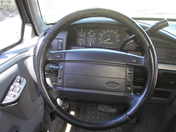

So here is what the old one looked like.

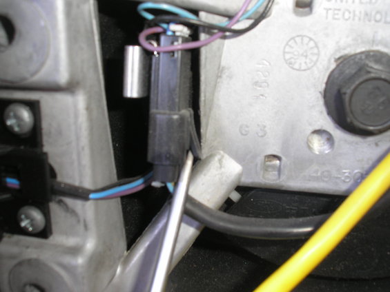

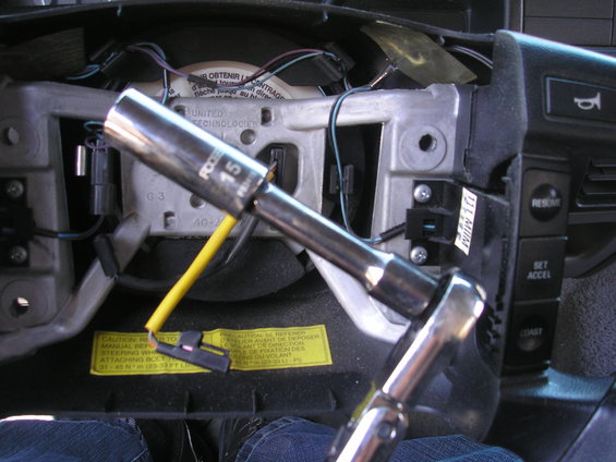

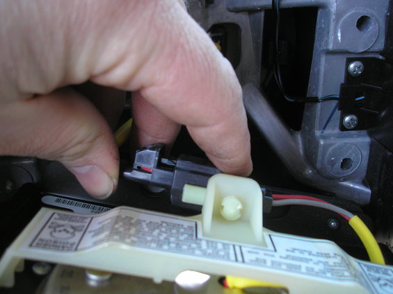

Now diconnect the connectors.

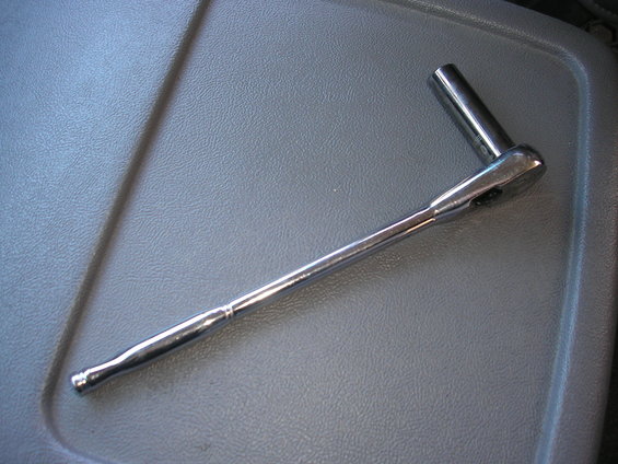

Next get a 15mm socket and a ratchet.
Or if you are lazy you can use one of these.

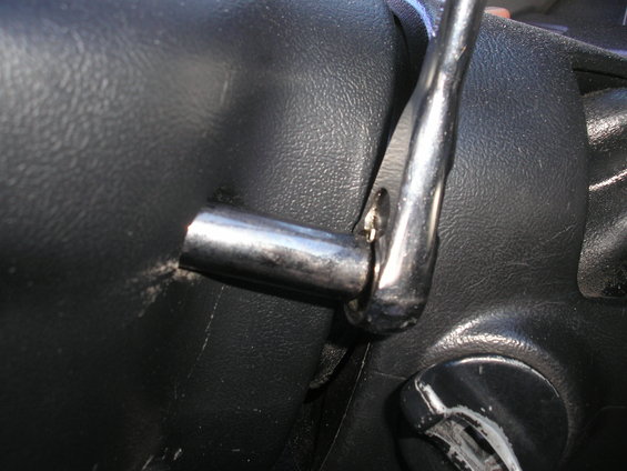

Now you need a steering wheel puller.
Put the puller on the wheel and remove.

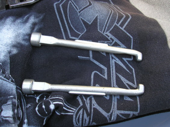

On a side note the new steering wheel has a different way to be removed and needs a different puller, i did not use this one but here is what i would look like.

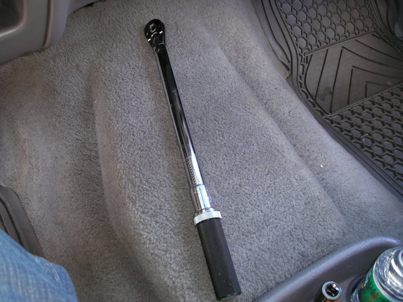

On to the install,(I guess i didn't take pics of this part) put the new wheel on and install the bolt the bolt and torque the 30ft pounds.
And reinstall the connectors.

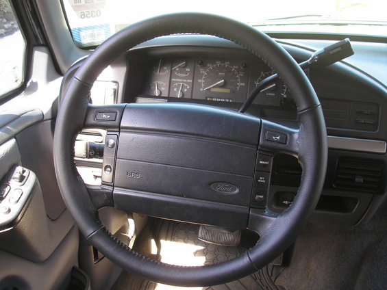

And here is the new wheel installed with the factory wrapping. :toothless

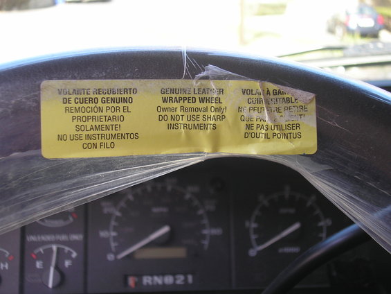

And the the sticker.
And the thing i almost didn't want to do, remove the wrapping. :cry
So their it is one new steering wheel installed. :thumbup
