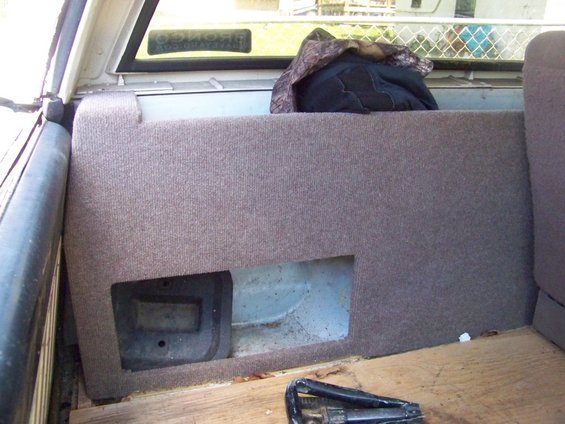

I have been working on it off and on for a little while now an trying to get a comfortable and functional interior layed out. The plan is to have room for 6 or 5 with the middle seat in the front down cupholders for 4 enough room for 6 longuns without having to have them in a guncase and out of site. Also I wold like to be able to sleep in the back with out rearranging the whole backend of the Bronco.
I started out with removing the pastic trim in the rear I then started building two plywood boxes for each side
I welded angle Iron brakets on the side of the tub for the the boxes to bolt to
I layed down a piece of plywood on the bed floor I used 1/4" strips to take the space up between the floor ribs
These are pictures of the boxes installed showing the cup holders upper storage and rear storage cubby holes
My next job is to install the rails the cargo cover/ sleeping rack will set on and do the final trim work.

So far I have been able to fit 4 long guns on each side 1 of which was a scoped muzzleloader with the tall scopemounts that you can sight off the iron sights with also. I made them so the riffle or shotgun just sets straight up and down. I so a picture later they came out good. Thanks

I have lids for the tops I just haven't finished them off and installed and I have considered covering the whole thing in fiberglass to make it waterproof when the top is off. Sorry about the small pics they were from my phone and if I try to enlarge them they are very pixelated. Next time I get a free moment I' toss a few rifles and shotguns in there for you and take a few pictures.
